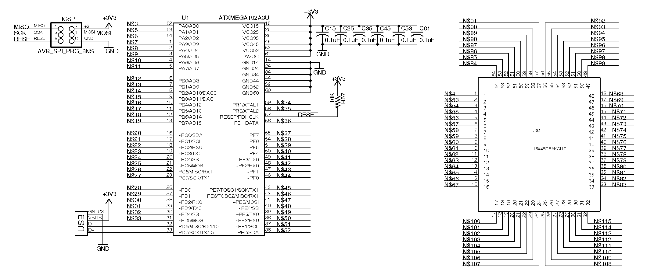

Here's what I've come up with so far.
TQFP, right? The pads look "short"... or something.
I made the pads 1mm x 0.45mm, extending from the maximum body edge (+/- 7.05) to the maximum outer dimension of the legs (+/- 8.125). The L dimension of the drawing shows the leg contact area as 0.75max by 0.45nominal.
You think they should be a little longer? Extending out more?
Overlaying the 2561 pads to the pads I made, it looks like the 2561 pads do look a little wider and longer. That's probably good for machine placement, I think mine might be a little more foregiving for hand placement? (pad width anyway, longer I guess would not make much difference).
I dunno; It's not like I have any actual experience building anything with that package - they just looked a out-of-proportion (which is hard to tell on a small-scale picture, anyway.)
I checked the Eagle reference-package library, and their TQFP64 (0.8mm pitch) has pads 0.5588x1.1938mm (22x47mil)
I wish I was better at manipulating across libraries, I could pull in the Atmel pads for 64 TQFP with my schematic symbol to have the 'standard' footprint for the board.
I do like the idea tho of somewhat narrower pads for more solder mask between legs and less chance for solder bridges when hand assembling. 0.8mm pitch and 0.5588mm pad width only leaves 0.2412mm for solder mask, = 9.4mil? I think iteadstudio likes 8mil min between pads.
I second that. I would have to grind the s### out of the solder iron tip to sharpen it up enough...
