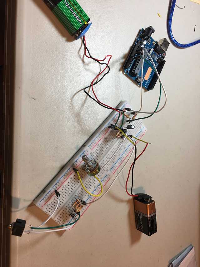

Audio analyzing circuit only outputs 0 and 1023 - why?
Hi all, I built the attached circuit, except I changed the DC bias resistors to 10k and the feedback resistor to 2k, and removed the 47uF capacitor. I know the DC bias works, since when no sound is played, a value of ~512 is printed to the serial moniter.
But whenever I play any sort of audio, only the values 0 and 1023 are output - why is this? I know I should be getting values in between 0 and 1023.
I tried to troubleshoot the best I could. I don't have an oscilloscope, instead I used a multimeter to measure the AC voltage output from the audio jack. My multimeter only has one decimal place, so I got values between 0.1-0.2 volts when playing at max volume. I'm assuming my problem is that the signal is not "loud" enough, is that the reason I'm only getting analog values of 0 and 1023?

From the symptoms you describe I would think that the problem is the signal is too 'loud' (to use your terminology) and is clipping, which means it is only ever at the highest and lowest level. Try reducing the level slowly down to 0.

What AC level is measured on A0 with ~100Hz input.
With no input do you get 2.5VDC A0 to GND ?
Show us a good image of your ‘actual’ wiring.
Give links to components.

I got the 0.1/0.2v AC readings from the ground and one of the other pins from this audio socket: AUDIO 3.5MM – SAYAL Electronics (On the schematic it is between the upside down V's connected to the op-amp terminal.
I then tried another AC reading from the node in between the two 100k resistors (on my circuit they were 10k), and got values ranging from 2.2-2.4v. It never exceeded 2.5v.

This is where I am confused. If I am getting multimeter readings of 0.1v at the audio input jack, how can I be getting a signal that is too loud using my amplifier configuration, or did I do the math wrong?

I'm getting 6.0v, positive to the A0 node and negative to ground with my multimeter on the AC setting.
larryd:
No, surprisingly I'm getting 5.0v on the dot and I'm not sure why.

I've compiled a couple of images of the circuitry in an imgur album: https://imgur.com/a/oPlQH9k

Not withstanding the comments about multimeters not being accurate at low voltages, 2.4VAC is 3.39V peak and 6.78V peak to peak, well into clipping at the input of the Arduino. Your results don't surprise me.
Multimeters measure RMS, your Arduino is seeing the peak to peak voltage, not RMS.

This is very helpful. So does my feedback resistor need to be a much smaller value to produce less gain, as my arduino can only take 2.5v peak to peak?
Also, I mentioned in another comment that I was getting 5v into A0 with no sound, which I don't understand. With the voltage divider, it should be 2.5v, no?
Does my feedback resistor need to be a much smaller value to produce less gain?
Yes. As shown the circuit has a minimum gain of 11 with the pot adjusted to maximum value.
With no input it should be 2.5V, yes. If it is not then something is not how you think it is.

Sorry man, I don't know what you mean by 'actual'. I uploaded an imgur album with pictures of my circuit irl, if that's what you mean.
This low resolution of your image makes it impossible to trace out your wiring connections.

Hi Larry. I realized that I made a mistake when measuring DC voltage from A0 to GND. I do in fact have 2.5VDC (2.36v to be exact); I stupidly left my multimeter on the AC setting.
As for 100Hz input, I get an AC reading of approximately 5.8-6v. Correct me if I am wrong as this is new territory, but this 6v reading is an RMS reading, which, according to an online calculator, has a peak voltage of approximately 8.5v. I should be shooting for 2.5v peak to peak correct? So I need a much smaller feedback resistor value in order to decrease the gain?
