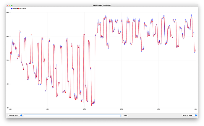

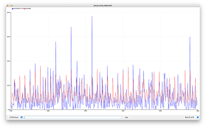

While awaiting judgement on the suitability of electret microphone boards, I tried out another product at hand. Quite impressive that, in a silent room with no windows, aircon, etc., it picks up the ticking of a BRAUN alarm clock two metres away. The second screenshot is music playing at half volume from a laptop a metre away.
The output of this "ready to go" decibel meter breakout board matches the output of this app surprisingly well. No replacement for a professional calibrated product of course, but not too shabby either.

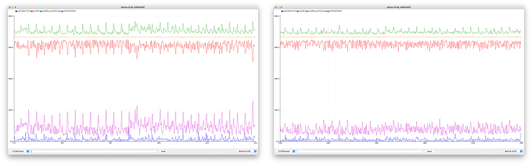

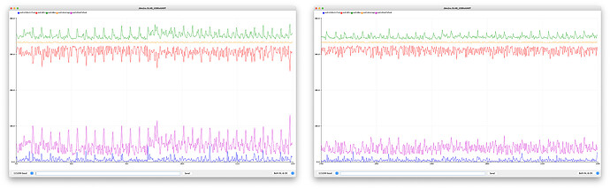

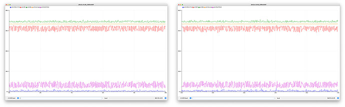

So, back to the ways noise can be reduced. Got a new microcontroller and new microphone with amplifier MAX4466, gain pot in default position between 25 x and 125 x, powered from the microcontroller's 3,3V output pin, which is powered from a 5V 2A wall PSU, no other components connected.
Windowless room, no aircon, etc., 3,3 V AREF and audio off and audio on compared. With audio off, quite noisy signal. Also, value range much lower compared to input from a headphone jack. But that's the way it is, I suppose. Apart from the noise - is the code I obtain RMS with ok?
The microphone datasheet mentions a sensitivity of -44 dBV, so that means microphoneSensitivity 0,00631 VRMS, right? The gain pot is set to half-way between 25 x gain and 125 x gain, so I assume 75 x gain, which would equate to 37 dB according to this source.
With 20 * log10(audioRMS/microphoneSensitivity), I should be able to calculate dB(SPL) on a hobbyist level, so I can compare to the "ready to go" decibel meter breakout board, the app, and a commercial dB(SPL) meter? Would that be a good way to go about it? Here it's done, but with the levelShift value of 512 ("AmpMax"), not the microphoneSensitivity value as suggested here. Some say this. Others say that. What do you audio experts suggest?

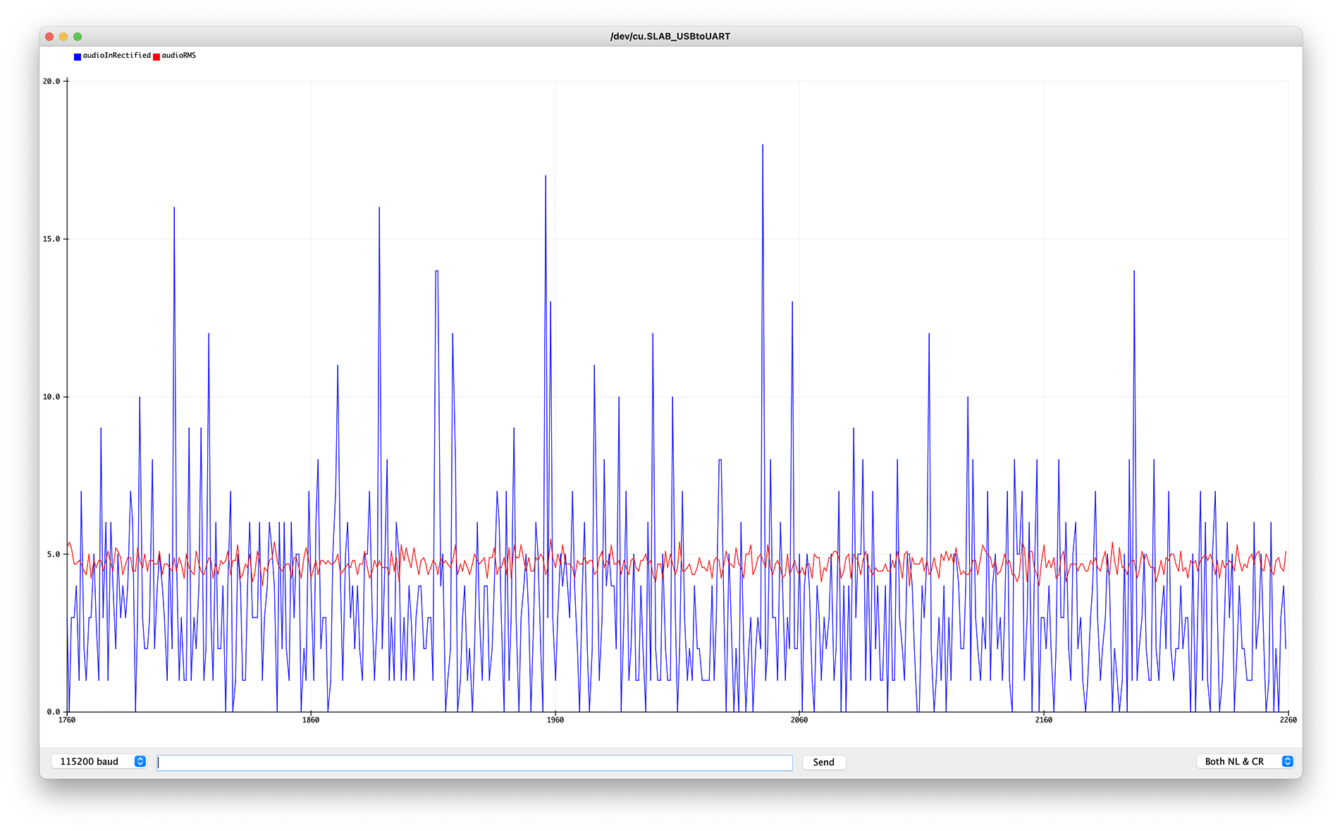

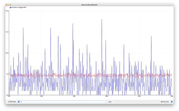

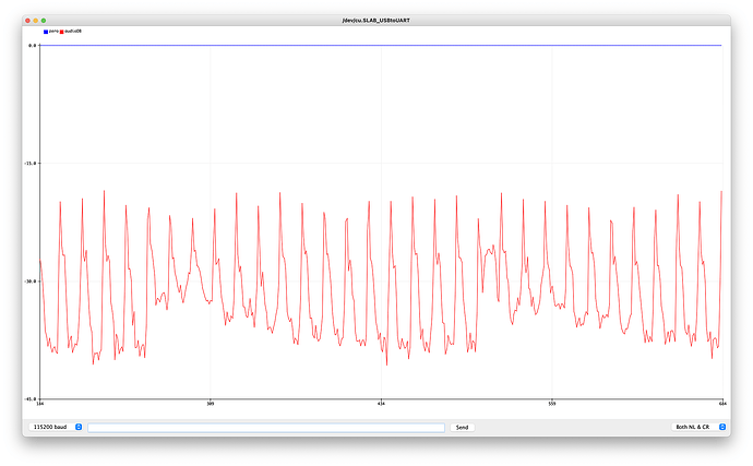

There's something wrong with obtaining the RMS - the 2nd screenshot shows the RMS value often exceeding the rectified signal from which it is calculated. So, what is wrong with the code, the way I obtain the RMS value? With that being wrong, it's no use to continue attempting to obtain dB(SPL). As this is an audio signal, a mishmash of countless superpositioned sine waves, not a pure sine wave, I can't just multiply the rectified signal with 0,707.

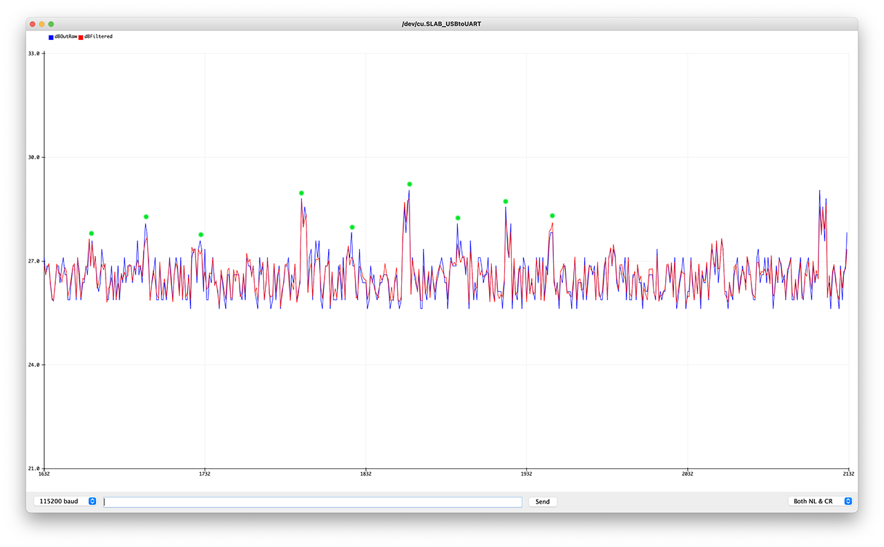

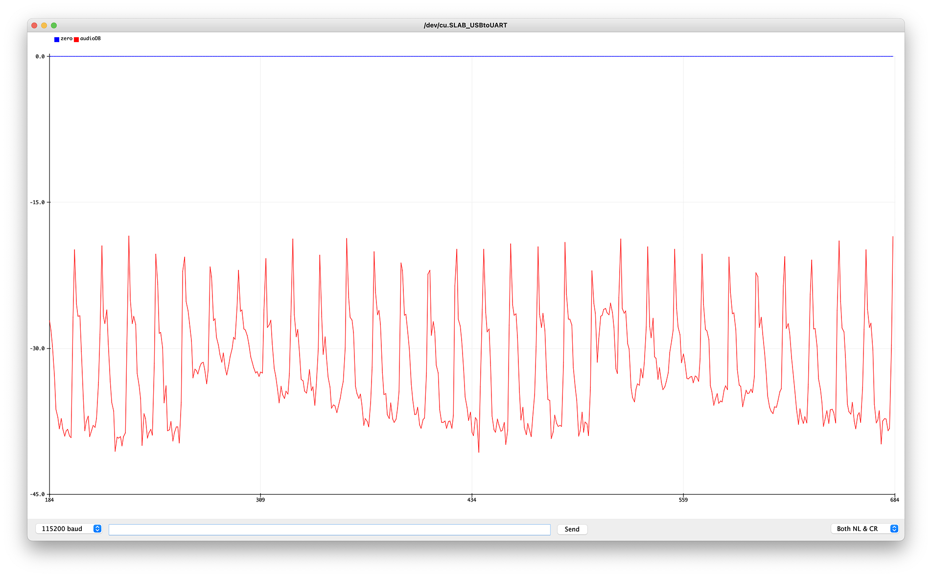

Putting the noise issue aside, I went ahead with the RMS and then dB(SPL) issue. The approach to calculate RMS with a time window appears to be the correct one, as the signal is based on noise, music or speech, not a pure sine wave. With that, I then calculate dB(SPL) with float audioDB = 20.0 * log10(audioRMS / levelShift); and get results that are 2 to 3 off in comparison with the app mentioned in post #10.
However, the microphone's sensitivity of -44 dBV (0,00631 VRMS) and the amplifier's default gain of 75 x (37 dB) are not accounted for. How should this be done? Maybe I can get a bit closer to what the app shows, and then to an SPL meter. I'd really like to find out how far one can go with this type of breakout board. Thanks!
