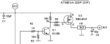

  3. I was wondering why the power LED on the Nano was glowing dimly always… DrAzzy explained it well. I am now clear thanks. In fact i have another version with more components on it, which works. The Vcc is 5V going to the MCU ; and the base of the SL100 transistor is connected to D2 of MCU. The Mosfet was a NDP6020P ; For shut down the MCU goes to sleep and also effectively shutting down all 3.3V peripherals.
Any issues with this setup ??

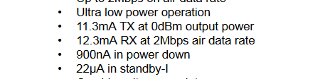

I assume with RF24 module you mean a NRF24L01+.
There is no reason to cut its power

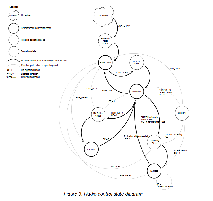

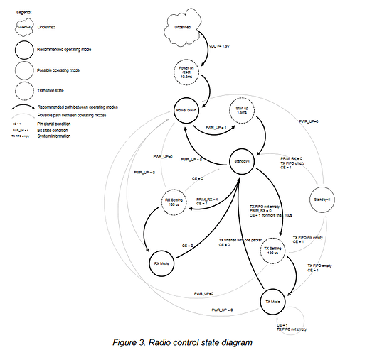

I can of course use the powerDown() and powerUp() functions and save lots of power. But just a query apart from this …instead of powering down, if i just use the read() or write() functions only when required , does the RF24 module enter the Standby_I mode when not executing either of these ?
Standby I is entered after begin() or stopListening(), and after a write() completion.

Don't forget that if you turn off power to peripherals and not the Nano, you can sometimes have the same issue with parasitic power through the protection diodes, only this time the diodes are in the peripherals not the Nano.
Whandall: Standby I is entered after begin() or stopListening(), and after a write() completion.
yes I have seen that State Diagram but wasn't too sure .. thanks for the confirmation. Sounds good.

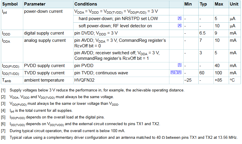

Seems so.
Section 8.6 on page 33 lists the power saving modes, how to enter and exit them, and what implications they have on functionality.

Seem to be the exact one I needed. Since I use the MFRC522 I was earlier searching for a Soft Reset function but could not find one. Looks like there is an easier option of Hard Reset by pulling the RST pin low.
Thanks to you guys, looks like there is no need for power switch at all ....atleast for now.
