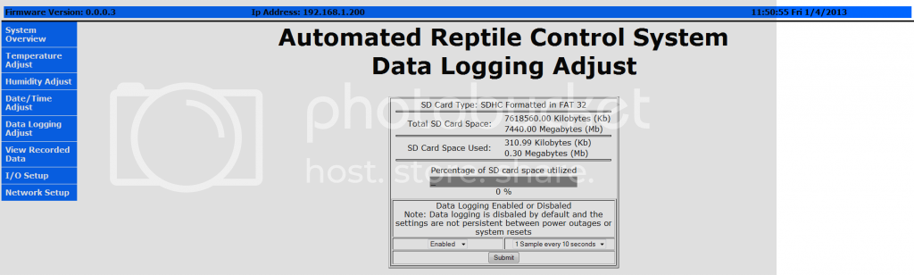

5.)Data Logging Adjust - allows the user to enable or disable data logging, allowing the system to log one sample every 10, 20, 30, 40, 50, or 60 seconds. This page also explains all the details of the SD card inserted into the Ethernet shield if no SD card is present, it will tell you and prevent the user from data logging. if the SD card is present, but not formatted, it will tell the user and prevent data logging if the SD card is present, formatted, but cannot be accessed for one reason or another it will tell the user and prevent data logging it tells the user the size of the SD card in kilobytes and megabytes it tells the user the amount of space used on the SD card in both kilobytes and megabytes, verified to read the same value as windows explorer it has a progress bar that shows the percentage of SD card space used data logging enable/disable settings are not saved to EEPROM. data logging must be enabled manually every time the system powers up. allows for the log files to be individually deleted off the SD card if desired (image does not show this part of the form as i have not updated the image i am using in this post ;) ). at 1 sample per 10 seconds, 24 hours of recording equates to approximately 3250 plus or minus 20 kB.

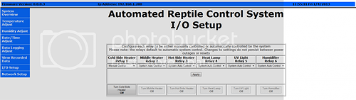

7.)I/O Setup- allows the user to decide how the 6 relays are controlled - either automatic, or manual. each relay can be configured independently. when the relay is set for manual control, then the user can press a button to turn it on or off when the system powers up, all relays are configured to be controlled by the system by default. any time the system restarts, resets, or is power cycled, the relays would have to be set back to manual control if manual control is desired.

in the data logging adjust page, i added the ability to delete selected data files and fixed a bug in my used space calculation. now the webpage displays the exact same value as windows explorer does. :grin:
