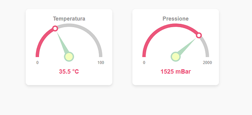

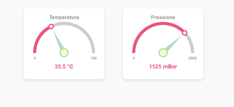

Some time ago, I developed a library for this MCU by porting the WebServer class included in the ESP32 core for Arduino.
I have added it to the official Arduino IDE repository also and all the examples you can find have been successfully tested.
The example stringLiteral.ino might suit your needs: the web page displays two gauges that are autonomously updated with MCU's random values using JavaScript (Fetch API).
I'm sorry for the Italian text, I will update in the next release.
