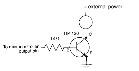

From reading a few pages, and watching a few videos, it seems that a transistor can be used as a switch. I think that would rule out the need for a relay in my case, because if I can achieve a switch with the transistor, why add a relay?
I think a bonus to using only a transistor would be eliminating the mechanical aspect of the relay, possibly making the whole thing more responsive.
So couldn't I just use a transistor?
I'm not sure on the voltages though. Would it work with 12v on the collector and 5v on the base?
If someone could explain to me the relation between the base and the emitter, I'd be grateful. From what I've gathered so far, the emitter's final voltage depends on that which is supplied to the base. I assume I would still need a resistor between the Arduino and the base.
5v from the Arduino to the base with a resistor in between, and then the 12v circuit from the vehicle would be run through the collector and emitter.
Let me know what you think, and if I'm missing something...
Also, I was half way through making a diagram for what I'm trying to explain, in the process I looked for examples of what the circuit symbols mean. I came across this

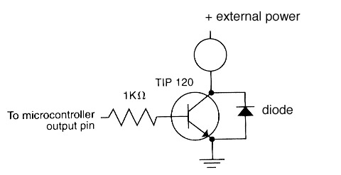

The top image is what I'm aiming for, but I'm curious as to why there's a diode in the second image... could someone tell me the difference? :slight_smile:
Thanks again!
Oh, ok. Sorry, I must have overlooked the line regarding the Snubbing diode. I read your post when I was half asleep. Thanks for explaining that.
