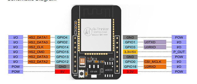

Is this your ESP32CAM?
ESP32-CAM Development Board | Buy in Australia | DFR0602 | DFRobot | Core Electronics.
Pleasee post an image of YOUR ESP32CAM.
Thanks... Tom....

Hello all, I received the ESP32 card so I tried to connect the camera and check if I can access. Unfortunately I understand this is not a AI Thinker board but a "non official", And I don't know which GPIO I should use in the code to access the camera, I tried several possibilities but I always finish with 0x105 error.
Here is the only sketch i've got :
I just remarked I don't have exactly the same writting on the metal part of the board. It says ESP32-S but there is not the FCCID marking...
