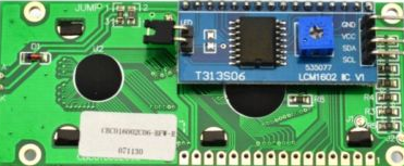

If you wanted a picture, need a picture, all you had to do was ask. I have attached photos. Please let me know how they help you.
So from your lack of details, I take it you have no idea what may be wrong or any other information on what may need to be changed to get fmalpartida library to work with the LCDs I have.
Can anyone else assist with what I may have to do to get the fmalpartida library to work with my LCDs. As it is the library listed from the Arduino website here, I would think it would be the preferred library to use. But I've not been able to get it to work.
adwsystems,
You appear to have some knowledge gaps in how the i2c backpacks work and the use of a constructor initialize a library as you seem to be not realizing why things are working/not working and how to properly initialize the libraries.
There are also some library interaction and conflict issues that have to be dealt with as well.

Here is some background to help fill in the missing gaps about i2c backpacks and libraries:
The i2c backpacks use a i2c i/o expander chip (PCF8574). Ignore the various versions of that chip as that is all noise and doesn't affect how it interfaces to the hd44780 lcd pins. Different versions of the chip have different base i2c addresses which is the only real difference between the different versions.
The problem you are experiencing with the libraries not "working" is due to the h/w architecture of this type of backpack.
The backpack contains an i/o expander (PCF8574) that has 8 i/o pins.
Those 8 pins can be controlled over the i2c bus using the Wire library.
6 or 7 of those pins are wired/connected to hd44780 lcd pins
1 of those pins is typically wired up to control the lcd backlight.
The issue with this type of design is that there is no standard way to connect the 8 i/o expander chip pins
to the hd44780 pins and the backlight control circuit.
So while the i2c interface and how you talk to the PCF8574 chip is all standardized, there is no standard that says which i/o pin on the i/o expander should be connected to which hd44780 pin or which i/o pin should be used to control the backlight.
As a result, different makes of the backpacks will wire the connections differently.
Because there is no standard way to wire up an i/o expander to a hd44780 LCD, there is no way to make a "plug and play" library that will work with all i2c backpacks. It simply cannot be done.
The library must "know" how the i/o pins are connected because it toggles the i/o pins to control the lcd and backlight.
If the library is toggling i/o pins incorrectly, then the lcd and backlight won't work correctly.
It is no different then when wiring up an hd44780 lcd display to use with the IDE supplied LiquidCrystal library.
The library must "know" which i/o pins are connected which hd44780 pins.
The IDE LiquidCrystal library has no default wiring and must be told by the sketch how the Arduino pins are connected to the LCD. These i2c backpacks are no different other than the i/o pins are no directly connected the microcontroller chip but rather are pins on a i/o expander that is controlled over the i2c bus.

fm's library on the other hand allows the sketch to specify how the i/o expander i/o pins are wired. This is why it can work with any of the i2c backpacks.
The reason that fm's library is recommended over others is because the pin mappings can be configured in the sketch.
The way these pin mappings are configured is by using a constructor.
Unfortunately, the examples in fm's library are not good examples of how to use the library.
(I actually dislike them and think they should be ignored, particularly the i2c example as it has several issues in it)
The i2c example does not use the full constructor but rather uses a partial one which uses a default internal pin mapping.
This default pin mapping is for fm's ElectroFun LCD i/o board, so unless your board matches that board (which is VERY unlikely as I've not seen any backpack so far use this mapping) it will not work with your board.
The best thing to do is to use fm's library but then use a full constructor to tell the library exactly how the i/o expander is wired up to the LCD and backlight circuitry.
In order to do that you use the full constructor which has all 8 pins and the backlight polarity, but you must fill it with the correct parameters of how the i/o chip is wired up.
The best way to get the pin mapping information is to visually examine the board to determine how the traces on the PCB are wired up to the hd44780 pins and the type of on board transistor for the backlight. For those with h/w skills this will only take a couple of minutes.
For those that lack h/w skills, I wrote the guesser sketch which was referenced earlier in this thread.
The guesser sketch, when used properly, will go through various combinations of pin mappings to determine the correct pin mappings. The mappings will be displayed on the LCD and on the serial port and the resulting pins can be placed in the LiquidCrystal_I2C constructor in your sketch.
While there are 40,000+ permutations of how to wire up a i/o expander to an LCD and backlight, there are only about 8-10 ways that backpacks are using and most use 2 different mappings.
The guesser will go through all those combinations to help less technical users determine which pin mapping is used.

From looking at the blurry photo of the backpack you posted in post #28, it appears that:
PCF8574 P5 connects to hd44780 D5
PCF8574 P6 connects to hd44780 D6
PCF8574 P7 connects to hd44780 D7
PCF8574 P2 connects to hd44780 E
And it kind of looks like (but it is very hard to tell with the blurry photo)
PCF8574 P1 connects to hd44780 R/W
While I can't see the other traces well enough to see where they go, that wiring
matches with the first two guesses which are the two most common wirings for these types of backpacks.
The only difference between those two most common wirings is the backlight control polarity.
The best thing is to simply look at the board. A good visual check can verify the board wiring in just a minute or so.
If you can't see all the traces because it is soldered then use a ohm meter to resolve the wiring you can't see.
These 3 wirings are the most common and have account for all the boards I've ever seen other than fm's ElectroFun board:
// EN, RW, RS, D4, D5, D6, D7, BL, POL
  { 2,  1,  0,  4,  5,  6,  7,  3, POSITIVE }, // YwRobot/DFRobot/SainSmart
  { 2,  1,  0,  4,  5,  6,  7,  3, NEGATIVE }, // Robot Arduino LCM1602/2004
  { 4,  5,  6,  0,  1,  2,  3,  7, NEGATIVE }, // MJKDZ board

Working on the picture of your board. I should have that backpack. The question is where.

Based on my ohm meter, the wiring corresponds to the YwRobot/DFRobot/SainSmart version. With the full descriptor in my program it is working. Still not sure about the I2CLCDGuesser.
