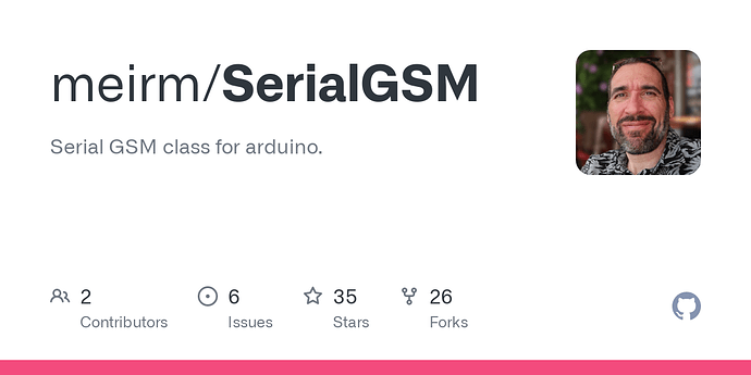

Hi all, i'm using this library:
to interface Arduino with a SIM900 gsm module.
The problem is that there are several delay inside the library, so that the exectution of some funcyion require several seconds sometime, blocking everything else, and i was wondering what would be a good way to rewrite it.
