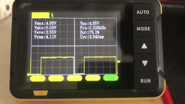

Hi people need some help here. Im using the AVR_PWM library to control a solenoid at a specific frequency of 340Hz. (TCU was controlling at this Freq)
I have got this to work so far via using fixed duty cycles (10, 20 , 30, 40 etc) using a push button. However i have progressed to where i am now using a 5k linear POT to control the duty cycle from 0 to 100%.
This works fine and i have achieved this but i get this problem where the duty cycle and frequency jump around and "spazz out" for lack of a better word. it can happen either when cycling the POT or even when the POT is not touched
This only happens when using the AVR_PWM library while controlling duty with a POT not when using a button for fixed duty cycles.
If AVR_PWM library is not used i can use a POT as intended but this will be a the stock Nano D9 pin frequency of 490Hz.
I have tried a combo of delays ranging from 50 to 150ms which don't seem to alleviate the issue
ezgif.com-video-to-gif-converter
I think the problem is in the scope trigger. It appears to lose when the PWM goes to 0 or 100%. Cut the range and see what happens.
hi gilshultz i did adjust and still got the problem. i also attached an led to the pin being tested and i can see the led flicker at all duty cycles but it is more noticeable at the lower duty cycles as im less blinded by the light.
tired led test with NO avr pwm library and of course no flicker. super weird

Check for bad connections to the pot, the analog input, or a noisy pot (quite common with cheap ones).
Print out analogRead values, and look for sudden large jumps, either with the pot stationary, wiggling the wiring, or while slowly turning the pot shaft.

Thanks folks i did check the pot and made sure everything was working correctly @jremington it was fine.
I ended up using a different pwm library @marco_c i checked out the MD_pwm but saw that it limited the frequency to a max of 300Hz.
The library was just called PWM. This gave me the rock solid 330hz i was looking for without all that fluctuation.
