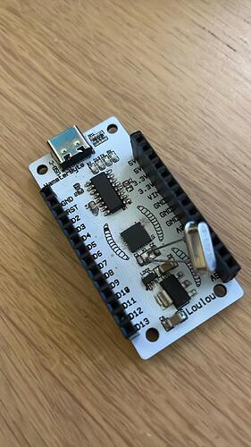

I am trying to make my own board, ive already made one with the atmega328p-pu and now one with the atemga328p-mu. I get like the error:
avrdude: Device signature = 0x000000
avrdude: Yikes! Invalid device signature.
Double check connections and try again, or use -F to override
this check.
when using a other arduino as the isp programmer and im using the following pinout as the programmer setup:
master slave
10 RST
11 11
12 12
13 13
5V 5V
GND GND
and heres the scematic:
 ![image](https://europe1.discourse-cdn.com/arduino/original/4X/3/7/7/3776b28986fbdd2a5361831312325a0d282c857d.png)
thanks for all help!

Why you didn't solder them? Please show a photo of the board.

![WhatsApp Image 2025-04-18 at 07.33.52_2430b377](https://europe1.discourse-cdn.com/arduino/original/4X/8/7/0/87073c7338bb4eef723e324aec9159892601e671.jpeg)
This is the board, don't look at the clock i used a smd one but apparently it is a oscillator and not a crystal and these where to only ones i had laying around!
<div class="post-metadata">
**Author:** ![thijmen\_fick34](https://dub1.discourse-cdn.com/arduino/user_avatar/forum.arduino.cc/thijmen_fick34/32/1107951_2.png) [@thijmen\_fick34](https://forum.arduino.cc/u/thijmen_fick34)\
**Post date:** [April 18, 2025, 7:39am UTC](https://forum.arduino.cc/t/avrdude-device-signature-0x000000-on-custom-board/1374378/11 "2025-04-18T07:39:30Z")
</div>
Okay so back to it, apparently there was a short between GND and RST and after fixing it it works perfectly, only thing is that the RX and TX lights are always on and the 5V led turn instantly off after boot and the D13 led doesn't blink (i uploaded blink code and the pin 13 with a oscilloscope it turns on and off but not the led?)
