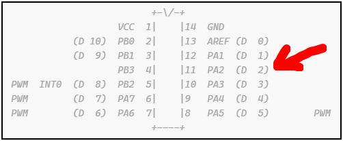

OK, I see you are using the old school "attiny" boards platform from David Mellis. So the Arduino pin mapping is as shown in this diagram:
So we would expect your sketch to blink an LED connected to physical pin 11 on the DIP package of the ATtiny44 IC (PA2):
Do you have the LED connected to that pin?
OK. Yes, when I assign LED = 2, pin 11 on the chip flashes the led.
