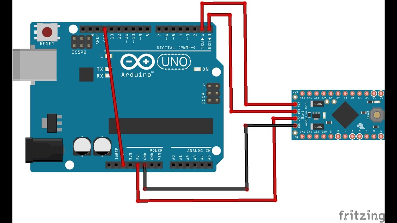

Here is a picture of my set up and the other is a diagram to the pins that I have connected. I have tried unplugging then plugging back in the power supply on both the pro mini and the uno and the same error pops up. I do not know the program that is on the Uno, but I was able to program the pro mini with the same connections with the Uno but then it stopped working and it now pops up with that avrdude error. I have tried using different wires and an FTDI and the message still pops up. Thank you for your time.
The images didn't attach so I found this one that is slightly how I set mine up. The only difference is instead of putting the GND to Reset on the Uno, I put the reset from the Uno to the GRN on the Pro mini.
How are the wires physically connected to the Pro Mini?
I used male to female wires from the Uno to the Pro mini.
