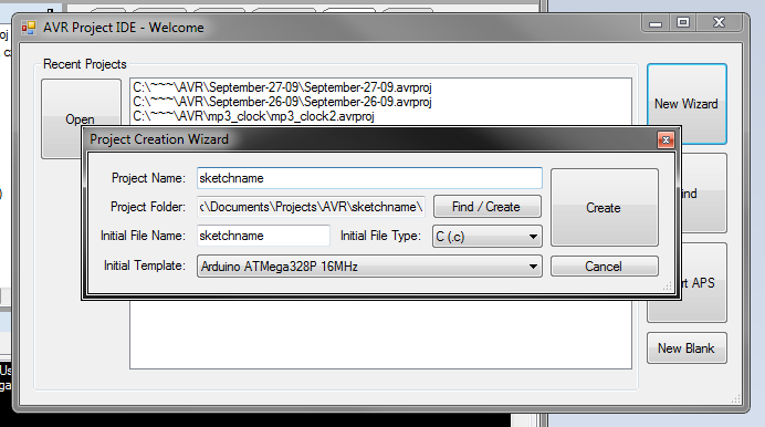

I've written a development environment for AVR microcontrollers that is geared towards AVRStudio and Arduino users. I have just posted the first alpha and I'm looking for the first batch of users to use it, test it out and give me feedback.
Here's some teaser screenshots so you'll actually go to my link and try it out
Distiguishing Features
  • Scintilla editor, with configurable syntax highlighting and indentation preferences
  • Docking subwindows and tabs, with workspace preference saved upon exit and reloaded at startup
  • Backs up open files with modifications in configurable time intervals
  • Supports the building of C, C++, and Arduino projects using WinAVR

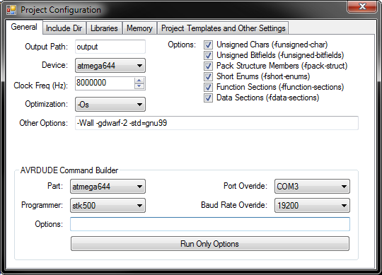

  • Quickly configure AVRDUDE and burn your project right from the editor
  • Customizable project templates, apply as much or as little settings as you want

Another file creation problem:
I used the wizard to create a new Arduino project (arduino 168 template and pde file type) I compile the code (with empty setup and loop functions) and get an unhandled exception re unable to find ...\temp\arduino_temp_main.cpp If I create the temp diectory the code will compile.
Also, it would be helpful if the wizard remembered the previously selected template and file type

edit pardon me, but how do i upload on a mega? I tried:
Atmega1280 Programmer: arduino Port: Com8 (my port, checked) Baud: 57600
Still i get a not in sync, what am i missing?
i'm not sure how the "arduino" configuration in avrdude works. have you tried the arduino mega template? the difference is that it specifies stk500 as the programmer, inserts the -F option for you, and uses 57600 baud, you still need to pick a port. If that doesn't work, go into command line and just type it all out and see if it's my editor's problem or something else.
avrdude -c stk500 -p atmega1280 -P COM8 -b 57600 -F -U flash:w:"filepath":a
