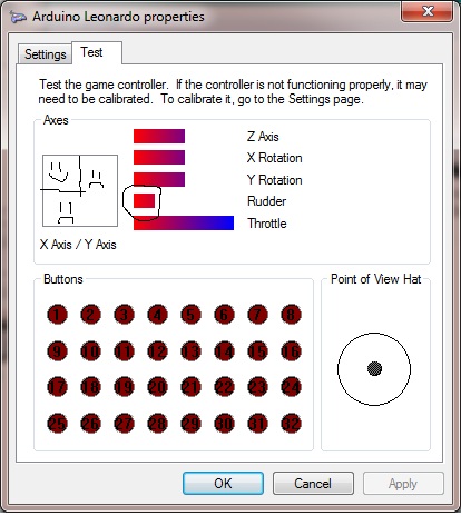

Hi people:
I',ve solved a lot of trouble with this project but this is driving me crazy...
An image worth more than 1000 words... (Image attached)
The happy face is the area where the axis move the problem is is not been possible make it work for the other area...
Rudder just came till' there and stop it and when i move the linear pot it cames till the end and reset the value (Something strange).
Here is the code:

Thanks a lot

Print the values being assigned to the joystick object. Somewhere, you are assigning an incorrect value.
Well guys:
The deal is: Changing the value:
 joyStick.xAxis = tempState;
Instead of "tempState" i put 1023 and the cross remain in the middle.
I put 511 and the cross reamain in the middle.
Same for the Yaxis.
Any suggest?...
