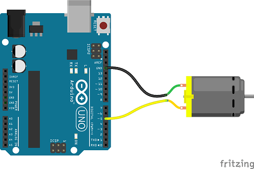

Here's one that's much, much worse:
That's the first thing you see when you click on Examples on the Johnny Five website. Johnny Five is the most popular Arduino project on GitHub. They are teaching many thousands of people to use Arduino without understanding the most basic concepts. For years, they even had another one of these examples that told you to connect a plain DC motor directly to an Arduino IO pin, which was only fixed in the last few months:
I wonder how many destroyed Arduino boards and sad, frustrated, confused beginners that was responsible for.
