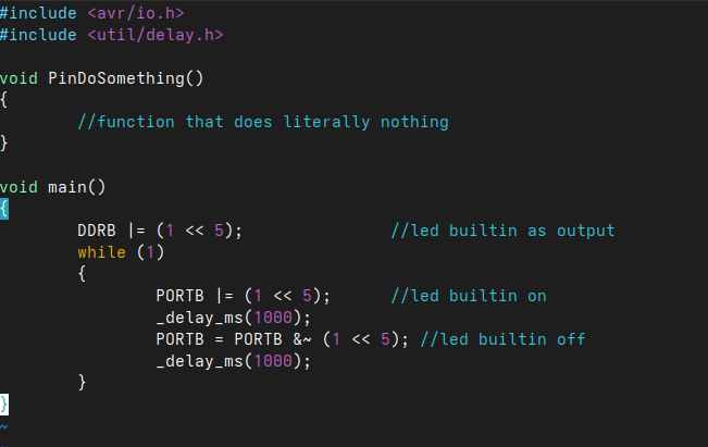

here is a code example, as you can see here, there's a void function up there that just does absolutely nothing at all, and yet, setting is as void messes everything up! However, when i set it as static void, everything is fixed, and the universe is in harmony.
So, what is happening? As i described earlier, the function is, for some reason, executing even when it's not called, except for whenever it's set as anything other than static.

also, a lot of people were criticizing me for it, so here's some example code that i made to illustrate this interesting problem:
as you can see, there's a void function up there that does nothing, but just having it there already messes up the entire code! Weird i know! The solution i found was setting it as static void, yet im not sure why that worked ): And the problem that i now face is with interruptions, as the same thing happens with them and (obviously) i cant set a static ISR()

Hello again friend! remember i'm programming it "bare metal", so only using C, no other tools, so i have to use main(). It's the norm. Here's some example code that i made to illustrate my issue:
this code (to blink the led_builtin) only works if i set the void function declared above as static void, for some reason (i tested it many, many times, unfortunately, and lost countless hours of my life) , while just having it as void messes up the entire code

how do you know PinSoSomething() is being executed?
please use code tags <code>, not images
Hello! Sorry for messing up again with the code screenshot, basically, i made it so that inside the function there was code to turn an led on, and sure enough, without mine calling the function, the led turned on, even though there wasnt code to so so in the main() function, only in this other function that i created that wasnt being called in any part of main()

it sounds like you're saying this funciton turned on the LED and the LED turned on without the funciton being called. is this correct?
did you post that code?
yesyes! let me post it:

i just rewrote this code, tested it again on my arduino uno, and it displays the behaviour i stated before! Strange problem! The led is turning on without mine ever calling the function!
Take a look at where the linker is placing the functions using avr-objdump

Is perhaps suggesting that adding 'static' caused the linker to locate the code for that function differently than it did without it

yes, yes, i also think that about the static, something about the mixing up of the program's main function address, that may be getting mixed up with that of the new function
also, i was just testing new code out, where the new function that i just created (the simple void function) lights up an LED, that is not lit up anywhere in the code, i am not calling this function and yet the LED still turns on! So the conclusion is that, indeed, the function is being executed without me calling it anywhere! so strange! hope you can continue to help me in this peculiar issue
