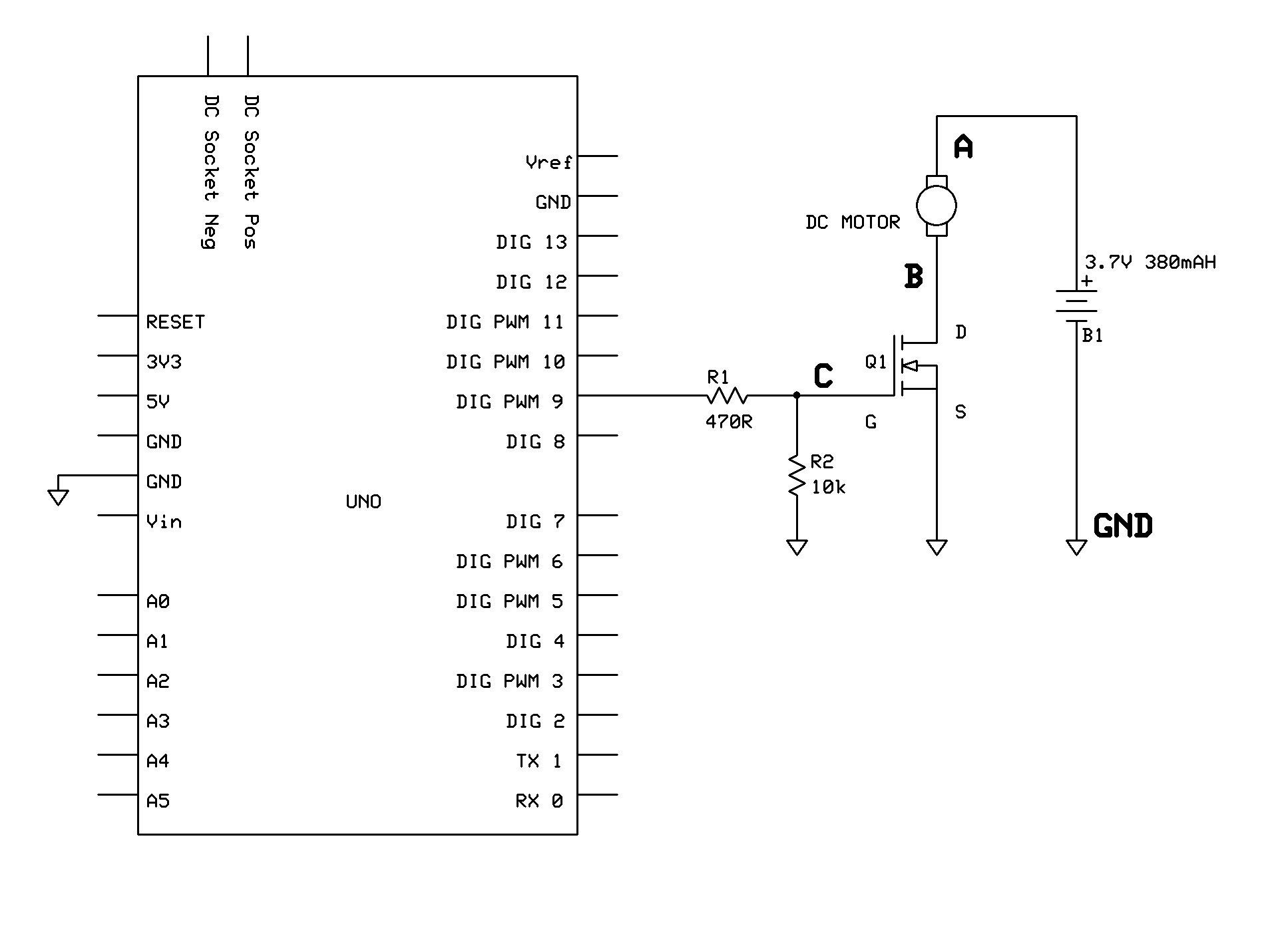

I have literally copied this Breadboard Layout | Arduino Lesson 13. DC Motors | Adafruit Learning System. the only difference is that I am using a mosfet instead of the recommended transistor
"a MOSFET" ?
Any further clues?
A schematic, maybe?
If you want to use an N-MOSFET to control a motor, wire it up like this with the gate of the MOSFET being driven by the Arduino directly (no resistor), and with a flyback diode in parallel with the motor (facing the positive side). The pull-down resistor is so that the motor is normally OFF. This is sometimes particularly useful to prevent a quick "jump" in the motor when you first power your Arduino on or if you forget to initialize the control pin properly, since the motor will only turn on if you set the pin to HIGH.
Try this circuit.
Using your power supply voltage , this is a generic diagram for instruction.
What is the part number of your MOSFET, is it a logic level type?
