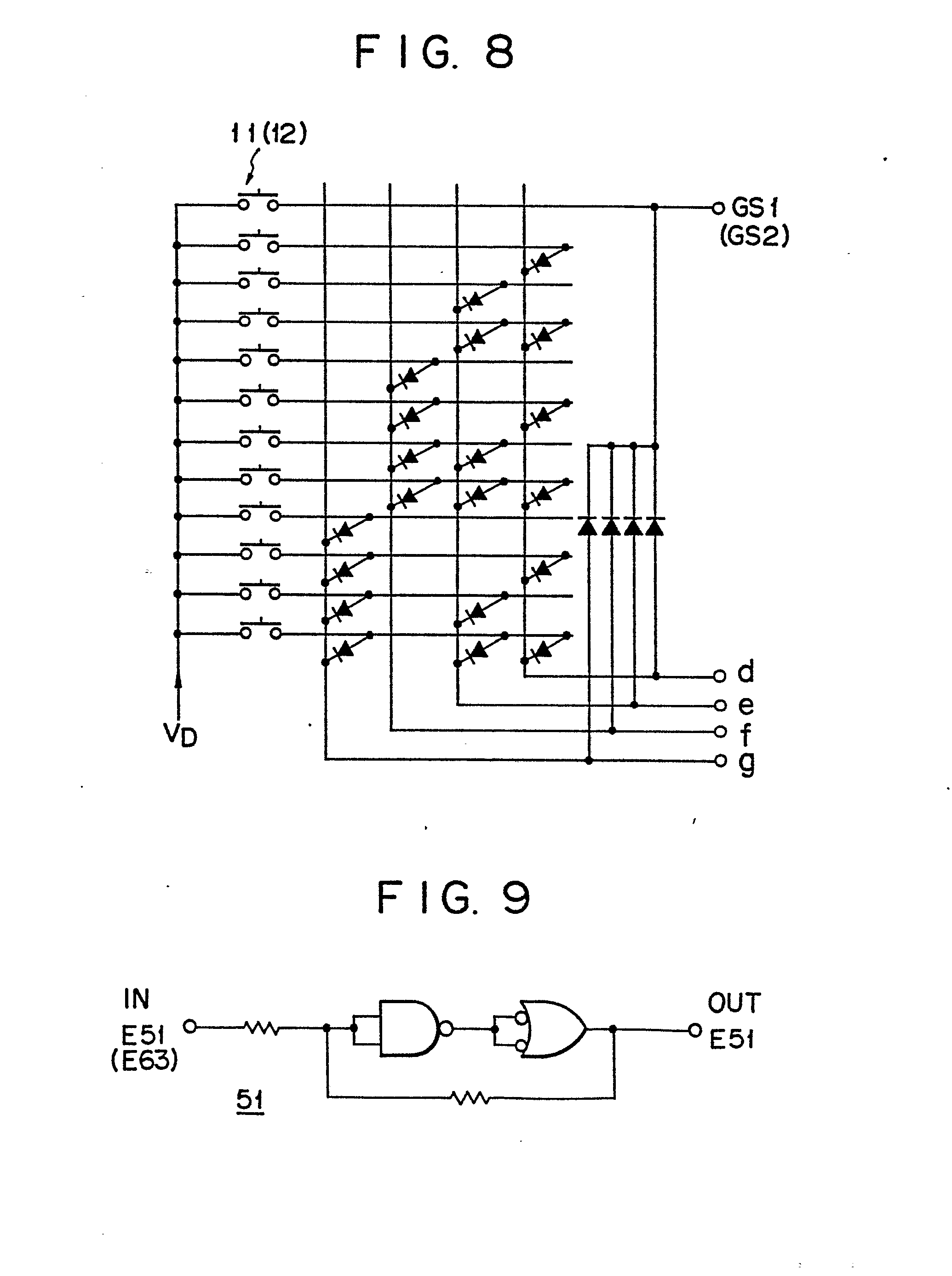

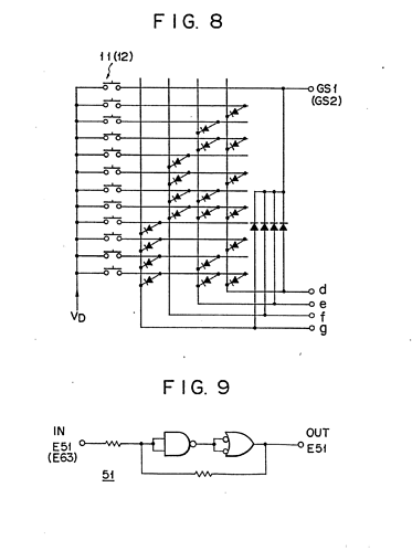

Yes, you can multiplex it to four pins You will need about 20 diodes. You will never be able to distinguish two or more buttons simultaneously pressed.
(Not the best diagram - will look for a better one later!)

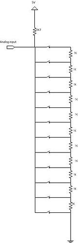

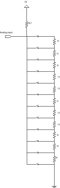

Another way is to use a single analog input, a 4K7 and 11 x 1K resistors. You will then get a different reading from analogRead() for every button. Combinations of buttons pressed at the same time will give strange readings. Is that a problem?
You would connect the common pin to the Arduino analog input, and also have a 4K7 pulling it up to 5V. Button 12’s pin would connect to ground. The other 11 resistors go between the pins for buttons 1 to 12 in a string.

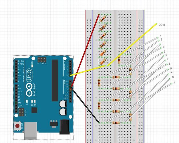

I’m sure I’m doing something wrong and I REALLY appreciate you taking the time to help someone so new to this.
As far as the 800ish: I was not planning on using the pound character on the keypad, so I omitted it. I wired it in just now and I’m now seeing it oscillating from 0 to 1023.
I’ve attached my first ever Fritzing diagram which I presume will be followed by, “Oh, you shouldn’t have done it that way, dummy!” :slight_smile:
Edit: To answer your question: Yes, I just wired up the pot like you mentioned and it gives good, steady values as I turn it.

madkins:
I've attached my first ever Fritzing diagram which I presume will be followed by, "Oh, you shouldn't have done it that way, dummy!" :slight_smile:
Ah, yes, that explains the readings you are seeing! When no buttons are pressed, A0 is not connected to either 5V or 0V, via resistors or otherwise. So it is "floating".
Take another look at my diagram and try again. You only need to move one resistor and a couple of wires.

Thanks for making me work for it. Once I realized the entire right hand side of the diagram was isolated from ground unless a button is pushed, it made more sense. I reworked a couple of things and it is working perfectly now. I’ll attach my updated diagram.

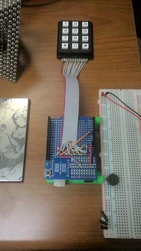

Prototyping went well, so I’m starting to wire up the final version. I’ll attach a picture. Now I just have to wire up my LCD screen, servo, and design and 3d print the housing for everything.
