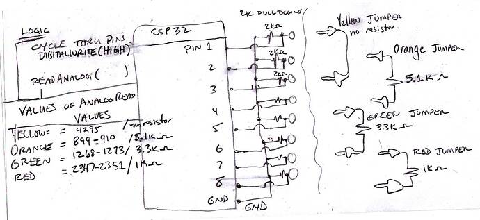

I think I got it now. Here is my schematic.
The schematic is voltage divider. The different resistors for each colored wire patch/jumper function just like a pot.
I use 2k pulldowns and added a different resistor for each jumper wire. I can now do all the requirements.
  1. I can see which specific contacts are made by cycling through defining pinmode to outputut and setting to high, then reading the other gpios with an analog read.
  2. 2k pulldowns mean I read 0 when nothing is connected (not floating)
  3. Adding a resistor to the patch / jumper gives good separation of values so I know what exact color of wire there is is.
This stage of the game is now 2 levels.
First the player tries different patch combinations. They press a button and I let them know how many patches are correct.
The second level is for the player to swap colored patch wires around which I can do with the different resistor values.
So problem solved.

Just returning to the game that you are creating, you have shown 2 different type:
Type 1 in the OP where it appears that patch wires can go between any 2 sockets. Type 2 in later pictures seems to imply that the patch wires can go only from one group of 4 sockets into the other group of 4 sockets (which is an easier problem to solve).
Another way of implementing this without using special resistor values, and still identifying the wires used would be to have sockets like two pin audio sockets
In the plugs you'd build in a DS2401 serial number device which requires only 2 connections. That way, you would not even need to connect pairs of plugs with wires. You'd simply colour code them. 2 reds, 2 blues etc.
Update. The schematic posted worked like a champ. The only issue was I ran out of adc capable pins on the esp 32 (fyi this chip is the real deal and will only get better with more library support). Since the esp 32 has 7 touch capacitance pins that also double as adc inputs, I had to kill one requirement. So I have only 4 adc pins. That means I couldn't do the requirement of having all cables plugged in for a test.
Thanks to all who the posted advice. It is appreciated.
