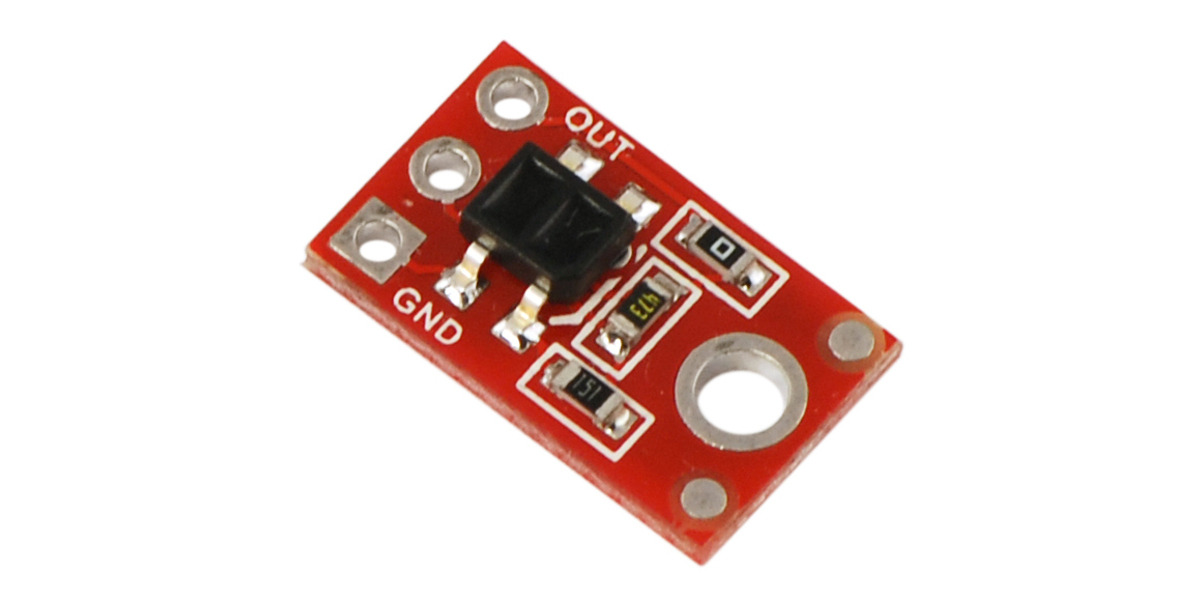

How about optically?
Put a series of 5 light & dark spots on each piece, and 5 optical sensors at each location.
Allows recognizing 32 pieces - or 30, if all light (no piece) and all dark (piece upside down, misoriented) are treated as 'error' states.
This kind of thing
make your own little board with 5 of them on it.
Maybe arrange in a square with 1 in the middle so puzzle piece orientation wo't matter.
