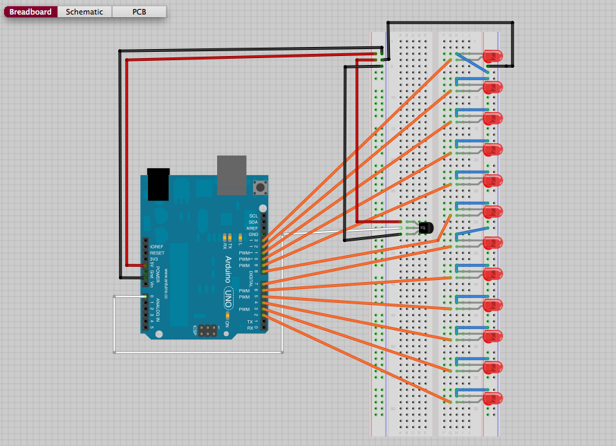

Having only been introduced to arduino and electronics in general yesterday I would greatly appreciate some advice on my circuit.
I am trying to make a thermometer with LEDs lighting to represent the mercury in a traditional thermometer as the temperature falls/ rises.
As I am a total beginner both in electronics and in C code I have so far only been able to get a temperature reading and i've only managed to light the top LED (BRIGHT!) and the one below it (not bright).

Based on your picture, you don't have any resisters with your LEDs. You must always use a resister with an LED to limit the current used. Try a 470 ohm 1/4 watt resister. That may or may not be causing to much draw on your Arduino for it to run reliably.
Thanks, will I need one resister for each led? I've only got a few of each resister (in my list above)..
If there will only be one LED on at a time, you might be able to share a resistor. If they're ever on at the same time, they should each have one.
Yeah the idea is that bottom light will be for example: 0 degrees C and the top one will be say 30 degrees C (havent yet decided on the best scale to use) so each LED will be assigned a temperature to come on at and for simplicity I will only have one LED on at once. Where would the resistor go in my circuit?
Also I want to keep the brightness of the LED's the same and something isn't quite right at the moment. I apologise for my lack of knowledge on this subject!
Thank you
If you tie all resisters to one common ground with a 470 ohm resister in line then all will have equal brightness.
