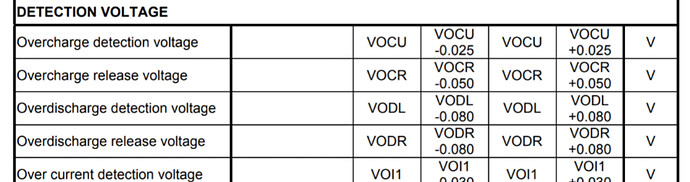

I attached an image from the datasheet regarding the overdischarge protection voltage of the FS312; but I can't make sense of it. For instance, what is VODL? (3rd row from top)

What datasheet?
This official data sheet for the FS312F does not have any entry related to the photo you posted in reply #11.
But, for the record, in my opinion the two chips appear to be interchangeable as far as circuit design and pinout is concerned.

Thank you! I opened a datasheet that came up from a Google search. I will try swapping the two chips and I will report on the result. Thanks!!
