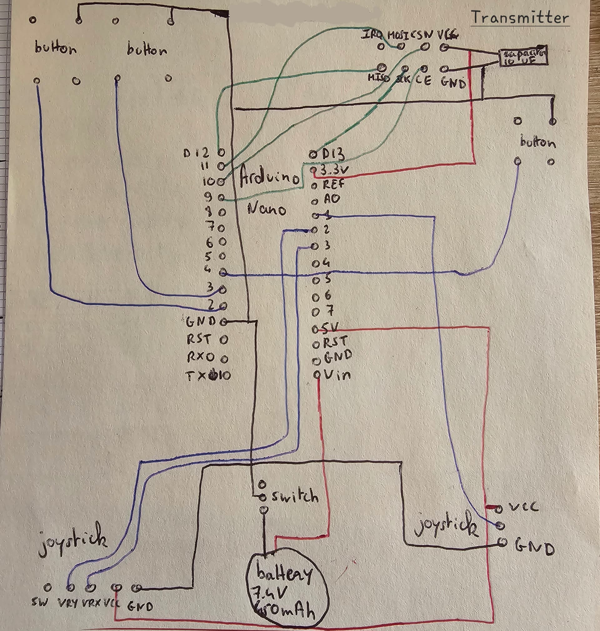

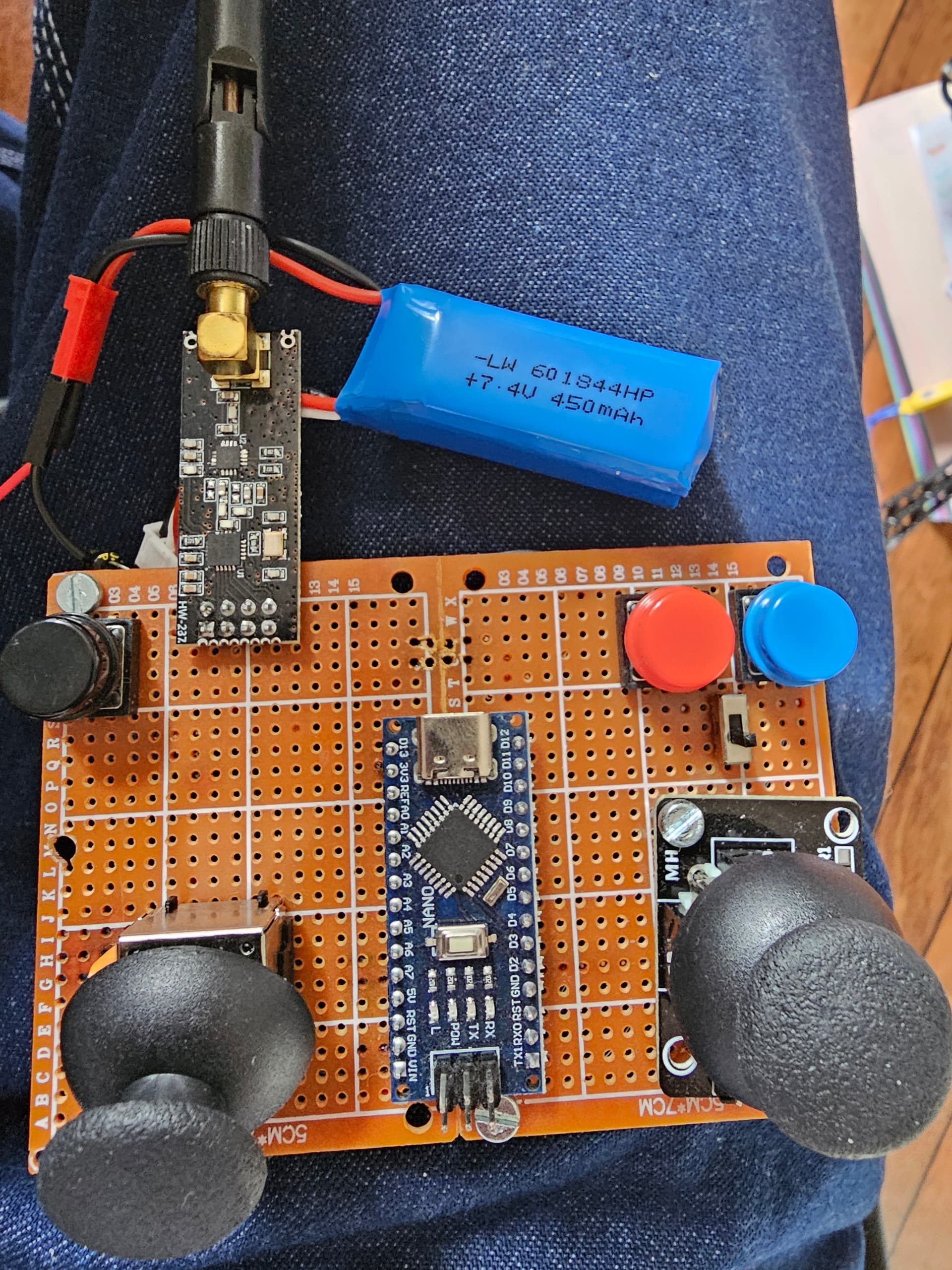

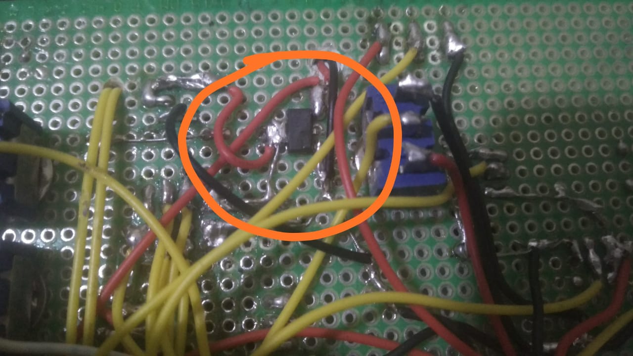

I'm trying to make a remote control with nrf24l01 transmitter/receivers, and it works fine when I'm powering the transmitter with usb. However, when I power the transmitter with a battery (7.4v, 450 mAh), it stops sending data. If i start it using usb, then plug in the battery and then unplug the usb, it works but if i start it directly with the battery, it doesn't. So I don't think this has anything to do with the battery. Am I missing something ? I also have a 10uF capacitor to regulate the 3.3v sent from the arduino to the transmitter.
Thank you for your help
Edit : It's an Arduino nano. You can see two voltage regulators on the board but they are not connected, these were for previous tests.

upload a schematic and give details of the battery used

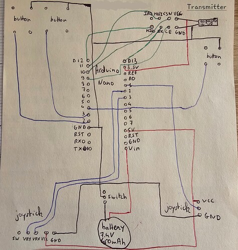

Serial.begin() isn't the problem. Please post a wiring diagram, with all pins, parts and connections clearly labeled.

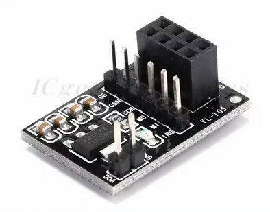

Depending on the Nano (clone) there may or may not be a discrete 3v3 regulator on board. The 3v3 may be derived from the USB chip which is active only if there is a USB cable attached. Even then you normally get only about 50mA which is hardly enough for a radio.
Here it is
I guess that you are going to need one of these adaptors, or build something similar.
(NRF24L01 adaptor)
See post #7 for an explanation. You may also be lucky with such a Nano clone described here: Do some Nano boards have external 3.3v regulator?

I see so basically the regulator only activates if powered on with usb and doesn't deactivate if I switch to the battery without turning it off in the meantime, but it doesn't activate if I start it directly with the battery ? If I understood correctly, isn't there a way to activate the regulator in the code?

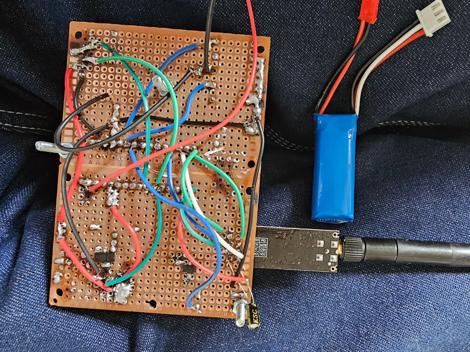

Can you post a picture of the Nano (both sides) or a link to the vendor page where you ordered it. Interesting will be if it has a separate 3v3 regulator and what USB/UART chip it has. Also include the code that you have loaded onto it.

Nano doesnt give stable 3.3v bro (cloning board?) You need nice voltage regulator such as, AMS1117 3.3v or use NRF24L01 breakout as shown by @6v6gt (this is better).
If you use AMS1117 3.3v you can add 1uf at VIN and GND of the AMS1117 3.3v to help it stable. Here's the schematic diagram I recommended!
(Sorry for bad drawing)
Make certain if the battery decrease the voltage so you need to connect the AMS VIN directly to the battery and Ground it to Nano board. (Note: 3.3v of nano board will give noise and unstable voltage).

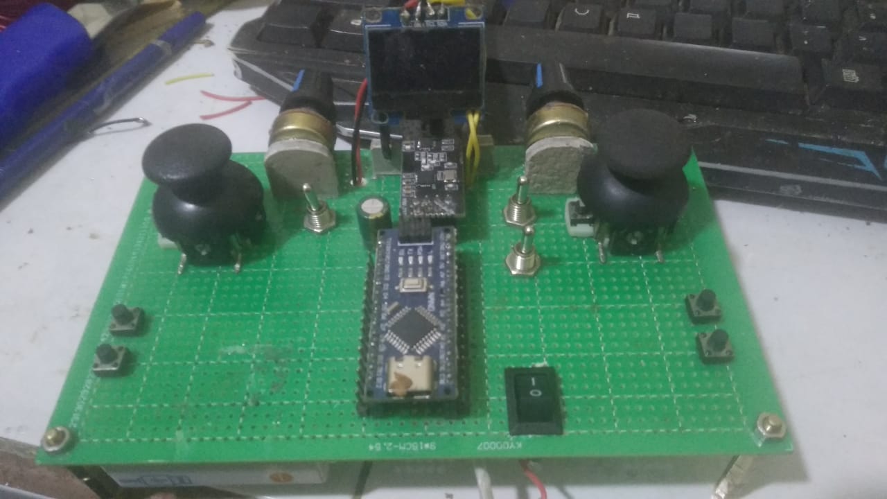

Mine with AMS1117 3.3v (SMD) (NO problem appears, works like champ!)

thank you, do you think ht7333 will work ? i dont have ams1117 3.3v. Sorry if it sounds dumb I'm kinda new to this

I'll edit my post to show a picture of the project

yes, HT7333 3.3v
(I'm a newbie too bro LOL, but I face withNRF24L01 perhaps, thousands times lol)
thank you for your answer, it takes 3.3v as input tho ? so its not the same as the ams
yes, it is a matter of pinout. HT7333 3.3v has VIN in the middle, OUTPUT at the right and GND is at the left. Just adjust the wiring.
So:
VIN pin connects to 5v VCC of arduino board
GND pin connects to GND of arduino board and GND of NRF24L01
VOUT pin connects to VCC of NRF24L01
