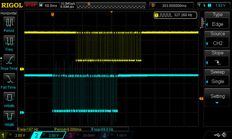

This answer came closest to my initial question: how long does it take to transmit a specific number of bytes at 2400baud.
Transmitting this message: 100,109.89,11.00,5,10,B and one startmarker, and one endmarker transmitted as a string (each character = 1 byte) at 1200 baud takes +/-225ms. See attachment (blue = TX, yellow = RX).
Edit: This is using HC-12 radio's set at 1200 baud for the serial link.

25 characters should take just less than 209 ms.
TolpuddleSartre:
It is about 208.3 ms ((23 + 2)*(1/1200)*10) which is indeed less than 209 ms.

But the scope printout shows more like 225ms..
brice3010:
Whatever is transmitting the bytes might be leaving a small gap between each byte, or it might be configured to transmit two stop bits instead of one.

HC12 datasheet says "8 databits, no parity, one stopbit"
