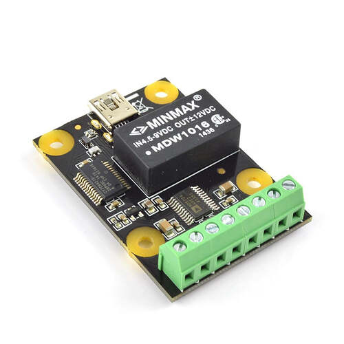

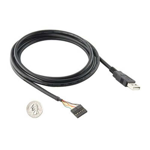

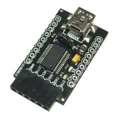

I'm looking for a way to talk from my Arduino to my BeagleBone Black. I don't have any available GPIO pins on my BBB, but I know there has to be another way. So I did some Googling and discovered some USB to I2C adapters. I'd like to use an Arduino voice-recognition shield (EasyVR Shield) to control what happens on my BBB. So Arduino (I2C pins) to BBB (USB).
I started digging for possible adapters/bridges. Links to those are below:
http://www.robotshop.com/en/devantec-usb-i2c-spi-serial-interface.html
http://www.robotmarketplace.com/products/0-A000053.html
Any and all suggestions are welcome. Thanks!
