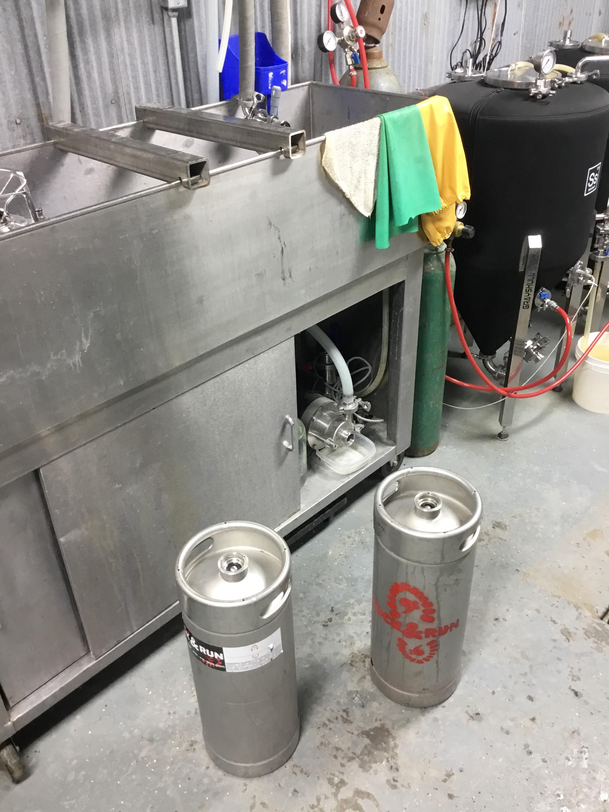

I currently have a very manual single head keg washer i built with all hand valves, but automation would save so much time. It doubles as a big wash basin and pump, piping and hoses all are used for CIP'ing unitanks as well.

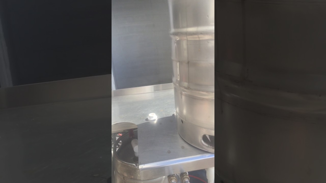

here is a vid of it running. Its very manual. like getting all kegs pbw'd and set aside, then washed with water and set aside, then fill basin with sanitizer and purge with co2 all kegs...time consuming and alot of hooking and unhooking sankey's.

I just helped with the coding and don't know the details about the hardware, but I think that the OP mtnmotion is at https://www.idolbeerworks.com/
Thanks for the info. I'll reach out to him. i updated my previous reply with some pics and old videos of my current manual keg washer.
you can see why i think i want to add some automation and possibly get this thing functioning with 2 reservoirs, pbw and sanitizer. tigging some stainless isnt an issue.
What i could do with 8 more hours when having to wash 30 kegs haha
