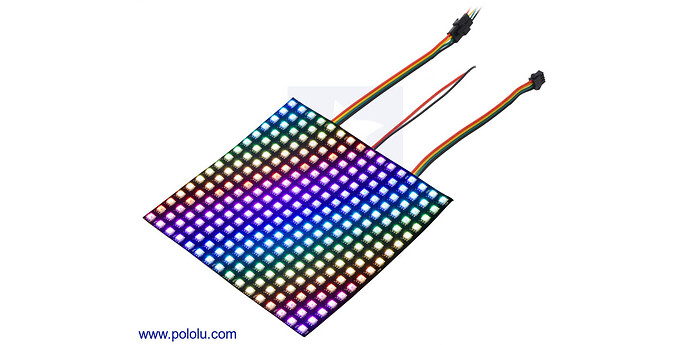

Ok yeah the leds would be 3v and the panel I was looking at is
8x32x24-bit RGB LEDs will need 768 bytes of buffer which is a significant chunk of the 2k of available RAM on an Arduino UNO.
Only if you need a buffer. If you are able to compute the values on the fly or load them from PROGMEM you can just push them out to the matrix as they're ready.
Granted, you'll need to write your own functions to do that, but that's part of the fun!
