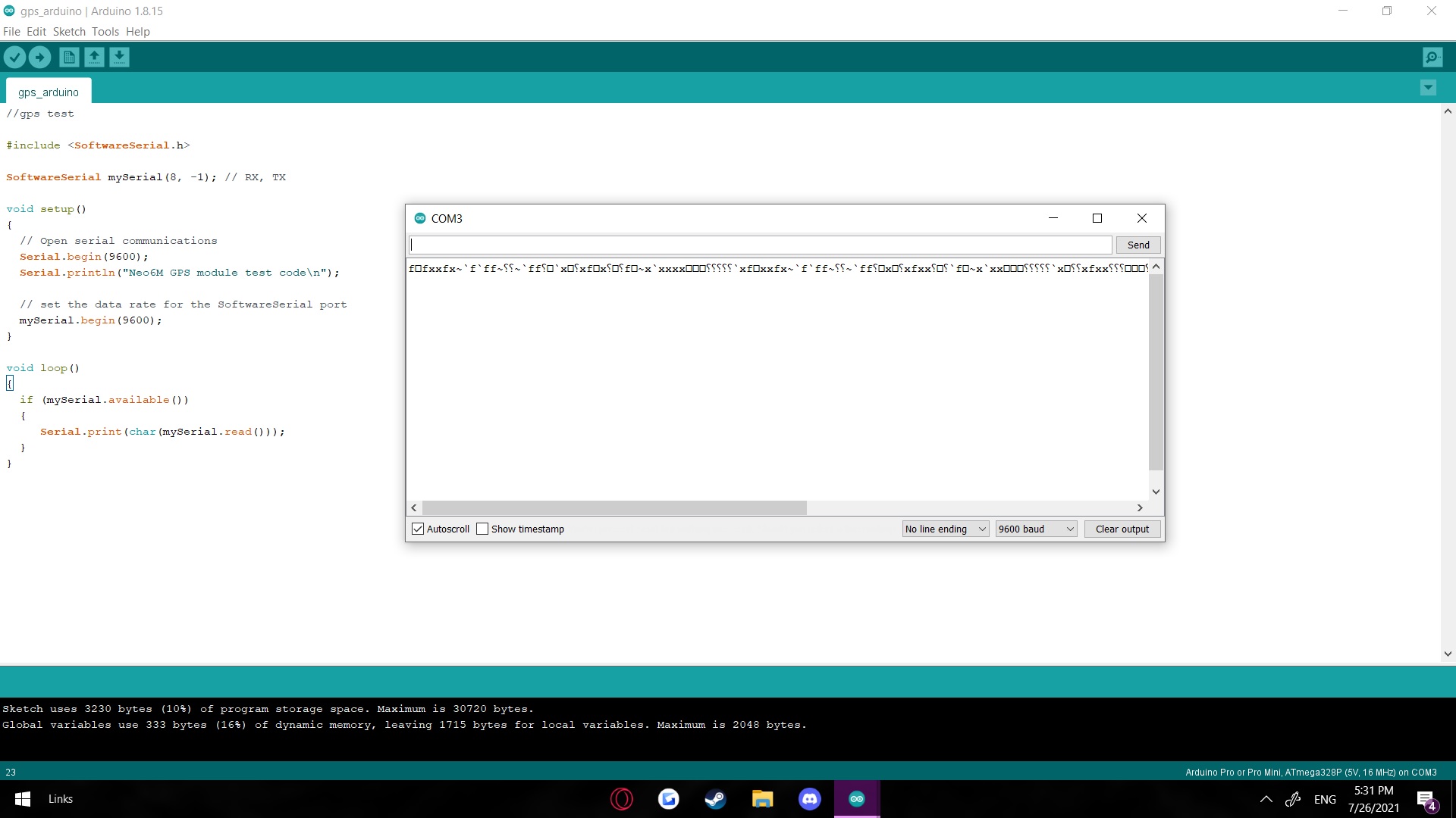

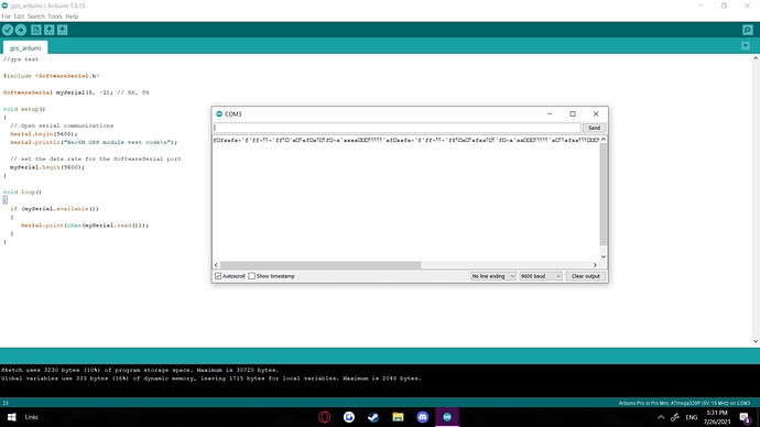

I tried it out again this afternoon, the sky was clearer than before and after 20 minutes or so the only thing I received was this:
 ![GPS](https://europe1.discourse-cdn.com/arduino/original/4X/e/0/8/e08623f5b38140742bd3cff3110ff2d16eba8e3e.jpeg)
I don't know if this is good or bad sign though, I've searched a bit but didn't find anything useful, just that "This is the result when no valid GPS messages are received. There are many possible reasons for this, including GPS not functioning, not seeing satellites, incorrectly wired, incorrect communications parameters, etc. ". Didn't find anything else.

That looks like you have a baud rate mismatch somewhere.

Hmm I'm new on this, you mean in the code or the COM3 prompt? I got the Arduino Pro Mini 5v 16Mhz and from the little I know it should work with 9600 but some people set the baud rate to 19200, I did switch to 19200 in the COM3 prompt but didn't change code value, I can give it a shot when the sky clears out again.

So you have the GPS TX pin wired to pin 8 on the Uno?
You should get at least the empty NMEA sentences that I showed in reply #3 even inside.
> $GPRMC,,V,,,,,,,,,,N_53
> $GPVTG,,,,,,,,,N_30
> $GPGGA,,,,,,0,00,99.99,,,,,,_48
> $GPGSA,A,1,,,,,,,,,,,,,99.99,99.99,99.99_30
> $GPGLL,,,,,,V,N_64_
_If you are seeing nothing readable like the above then there is a problem._
_Try changing `mySerial.begin(9600);` to `mySerial.begin(4800);` The usual default for the Neo6M GPS is 9600, but maybe the one that you have is different (I don't think so but it's worth a shot)._
_Serial should be at 9600 (`Serial.begin(9600);`) and serial monitor should be at 9600.

Yes, GPS TX is wired to pin 8 but it isn't the UNO, it's the Arduino Pro Mini 5v 16Mhz and no, I don't get anything anywhere, COM3 is empty. I'll try again adding what you said here, thanks again for your reply and your time!
