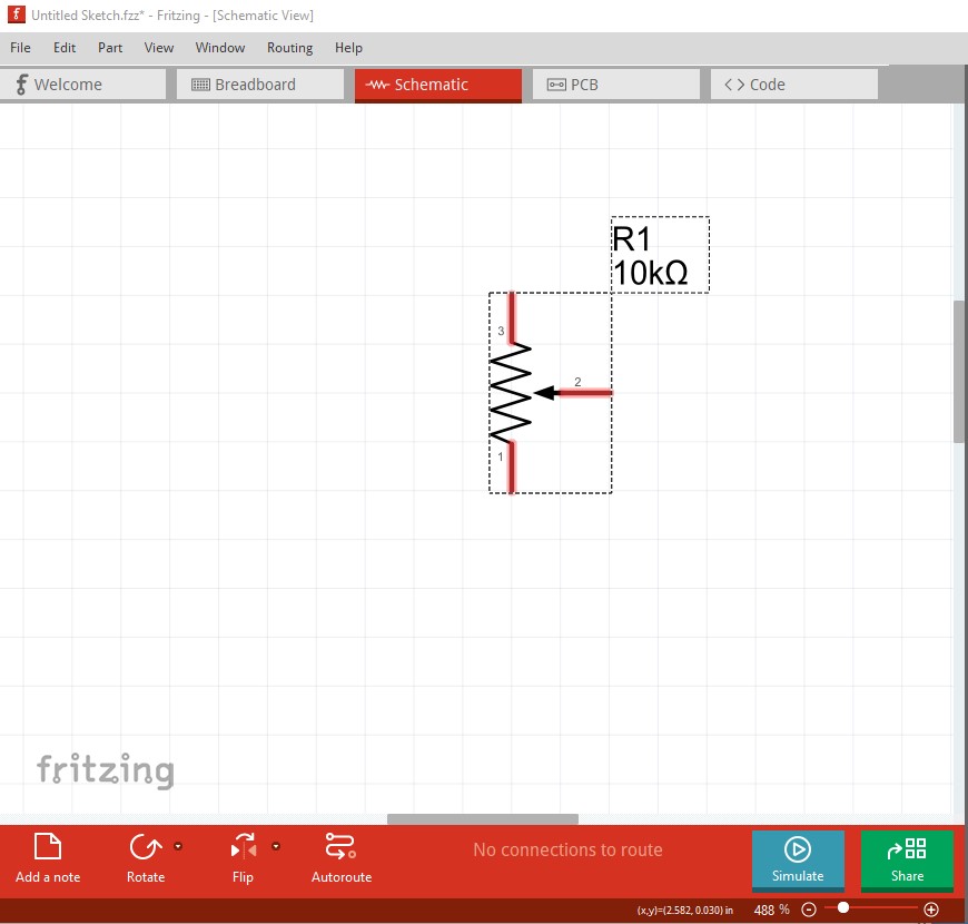

Those dots are express sketch "pins". They represent connection points for the component. The pins have properties like number and function and the properties are editable by clicking on the pin.
That clears that up. Thanks
The troublesome dots only show up in the version you're editing.
When the file is exported they're removed.
