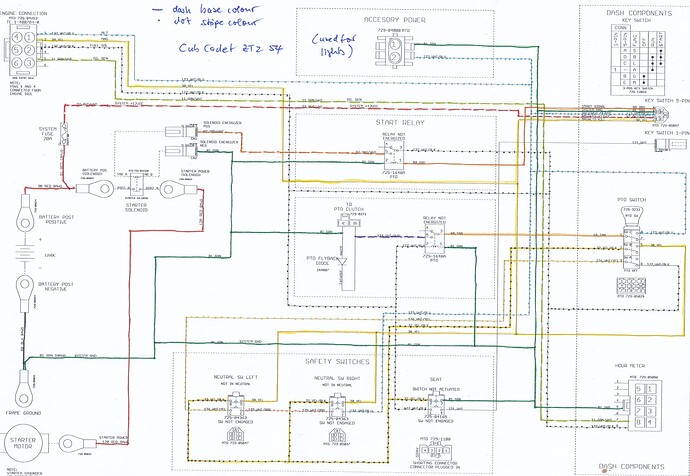

I am in the planning of 'electronifying a zero turn mower.
Instead of the rather genius wiring, which creates AND, NOT and OR logic for the safety aspect and operation, I am planning to use a MEGA to implement (as a basis) the same functionality.
I have mocked-up the servo control for the throttle, choke, left and right hydrostats, which was relatively simple.
However, next is the logic. and this is where my question comes in seeking some experienced guidance.
The logic will require a seat switch to be ON before the deck can be engaged.
The engine can only be started if the brake is ON and the deck is OFF.
The engine cannot be started when the deck is ON or the seat is OFF.
... and so forth, and combinations of these.
How to best implement this logic in software?
Should I set and read bits? Use the bits as switches.
Should I use a state machine? Could be difficult due to conditions?
Should I use normal boolean variables? Very legible code compared to bit setting?!
Or any combination of the above?
I have attached the wiring diagram to provide an insight into the logic complexity or simplicity :slight_smile:

Sounds like you need to get you head around the idea of a "state machine". To do this, you can draw a diagram with a small box or circle representing each state, and arrows going between the boxes representing events. Label each box and arrow with the name of that state or event.
The machine can be in only one state at any instant in time. The only way for the machine to get out of a state is when one of the events/arrows leading away from the state happens, and the machine moves into the new state indicated by the arrow.
Start by listing all the states you can think of. You won't think of all of them at first. You will realise there are other states needed as you work through it.
Use pencil and paper so you can erase your mistakes and draw in the corrections. This will take a few iterations to get right. Post it here and we will help by reviewing it for you. Once the diagram looks reasonably good, we can advise how to code it. Coding it is actually the easier part. Getting that diagram right, with all the states and events, is the harder part.

what is "deck"?
what about somewhat inverting the logic
    if (! seat)
        defeat engine (i.e. ground coil/magneto)
    else if (ignition switch ON)  {
        if (! brake)
            engage starter
i don't see a need for a state machine

The deck is the cutting deck of the mower.
When you look at the diagram (in the top/first post) you will see quite a few conditions, but I will certainly look into this.

I think we already answered the implementation questions more or less.
No logic in bits please. Trying to save one and a half bit while making the code less good to read is bad.
A Finite State Machine might be needed or not. They way you present the project, then it might not be needed, but along the way it might be needed and it does not hurt. Many conditions together with a Finite State Machine is no problem at all.
I have my own approach. When a sketch needs a Finite State Machine, then the sketch itself evolves into a Finite State Machine. I just sit there, looking at the sketch and see how it evolves.
You should hear me talk about the balloons with strings analogy: See every function/task as a balloon and the balloons are connected by strings, and the data is traveling over the strings.
I am very much into safety. And as stated this post is about the logic approach only.
There will be sensors, both electronic and mechanical, to aid the safety aspect. All these sensor will be served by I single kill switch input, which does what it is happening now = kill the engine, thus stopping movement and blades.
