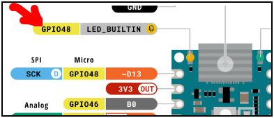

> [@yves14](#):
> then i tried the blink basic sketch, no more success.
Unlike when you have " **Nano ESP32**" selected from Arduino IDE's **Tools \> Board** menu, when you have " **ESP32S3 Dev Module**" selected from the menu you must use the GPIO numbers of the ESP32-S3 microcontroller as Arduino pin numbers; not the numbers written on the board's silkscreen.
You can learn the GPIO number for each pin by looking at the pinout diagram provided on the **Nano ESP32** documentation page:
[https://docs.arduino.cc/hardware/nano-esp32/](https://docs.arduino.cc/hardware/nano-esp32/)
You can open the simple pinout diagram by clicking the icon that looks like a male pin header under the Nano ESP32 board graphic near the top right corner of that page.
From looking at the diagram, we can see that the monochrome built-in LED is on GPIO 48:
 ![image](https://europe1.discourse-cdn.com/arduino/original/4X/a/9/0/a90f24dc2b4bec1b74a37aca39f6778aabbf4212.png)
> [ABX00083-pinout.png](https://docs.arduino.cc/hardware/nano-esp32/) by [Arduino](https://www.arduino.cc/) - [CC BY-SA 4.0](https://creativecommons.org/licenses/by-sa/4.0/) (cropped, annotated)
So if you want to blink that LED using the **File \> Examples \> 01.Basics \> Blink** sketch, you must change all occurrences of `LED_BUILTIN` in the code with 48. Make that change and then upload the sketch to the board. You should now see the yellow LED next to the USB socket on the board blink at 0.5 Hz.

Hi ptillisch, tnx a lot for your answer, really good, all you said is working here now. I need of course to understand a little bit more all that stuff 🙂 but i thank you really very much for these clear and complete explanations.
