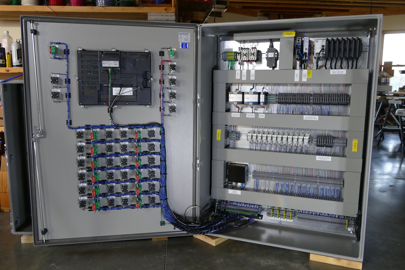

Last year I built a remote panel to control 12 wells at an unmanned site. Used a PLC ... a touch panel with a communications package so I can control it over the web. I put a micro PC in it so I can program the PLC remotely. There was no internet to I used a cell modem. First try at something like this ... normally I build small local panels with relay logic. It's been running for over a year now .. sends an e-mail each night reporting flows ... also reports if a well has a problem (had a lighting strike ... lost one phase ... popped all 12 overloads ... sent out 12 e-mails).
