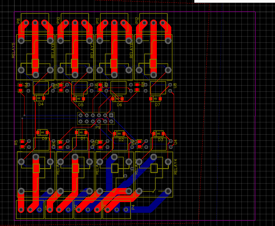

Because as I've said this is part of a larger design; I want to have as many I/O as posible.
Also because arduino UNO has very few analog inputs (which are cirtical for temperature reading).
For example, I atach the PCB and scheme for the relays (Which I have designed looking in diferent Arduino forum's threads :))
