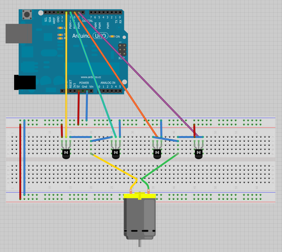

Oh yeah, my transistor H-Bridge with 500 mA NPN transistors are not working. See my picture in my first reply. What is wrong with the circuit? I checked the wiring and everything.
H-bridges using only NPN transistors are not terribly effective.
Do you have a schematic?
I copied this one: http://www.clear.rice.edu/elec201/Book/images/H-bridge4.gif
I wired it the same way as shown in Reply #2 of this thread.
