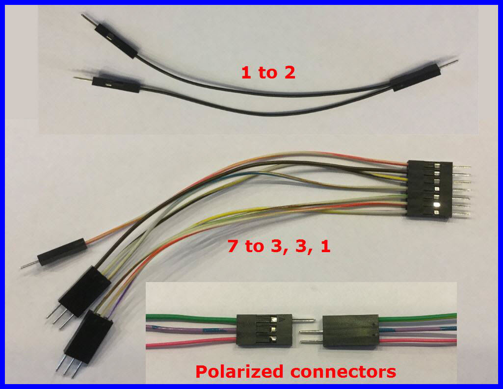

DuPont to header connectors are nice as you can unplug things as needed.
