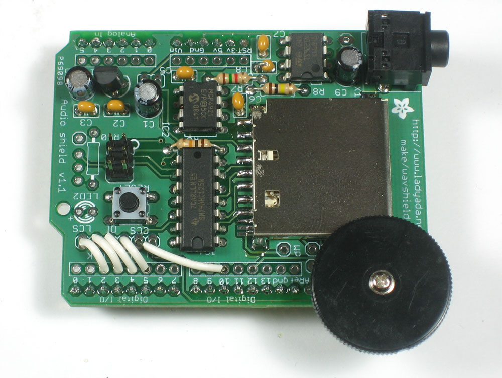

I had to "hack" the wav shield to work with the Mega Board by remapping these pins with jumpers:
The cable going from the "CCS" hole on the shield connects with the digital pin 53 on the Mega.
The cable going from the digital input/output hole 11 on the shield connects with the digital pin 51 on the Mega.
The cable going from the digital input/output hole 12 on the shield connects with the digital pin 50 on the Mega.
The cable going from the digital input/output hole 13 on the shield connects with the digital pin 52 on the Mega.

If it's the Adafruit Wav Shield, it uses that SPI interface for the SD card slot (Audio Shield for Arduino - FAQ explains pin-outs) and some of the other pins you mention for the Speakjet Shield are also used by that sheild unless you wired it up differently when you assembled it, or you can always rewire it to suit what you need to do.

I am using the Adafruit WAV shield. So to use the SPI interface for both WiFly AND the WAV shield, I just need to jump the Mega's SPI pins are 50, 51, 52 and 53 out to a bread board to share them between both shields? How do I wire the Slave Select pin? From what I've read, it seems that the SS pin has to be unique for each device. Does anyone have examples of how to wire up two shields that use SPI on a Mega?
I guess I should do more research to see if sharing the SPI interface for two different shields at the same time will be a problem...
The Speak Jet shield uses digital pins 2, 3, 4 (which conflict w the WAV shield)....and it seems they can't be remapped.
So it looks like I need to move the jumpers on the WAV shield from 2, 3, 4 to any of these pins 6, 7, 8, 9 or the 6 analog in pins (also known as digital i/o pins 14-20) and reassign them in the library (Google Code Archive - Long-term storage for Google Code Project Hosting.) I'm using?
Fortunately I haven't soldered any jumpers to the WAV shield yet and I have lots of pins with the MEGA, so it looks like I have some flexibility.
