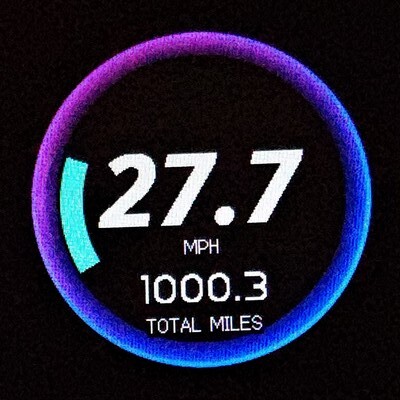

I could use some help understanding the touchscreen. Let me know if you have any questions. Here's what the screen looks like and the area where it says TOTAL MILES should switch between the various modes (TRIP MILES, AVG. SPEED, etc.).

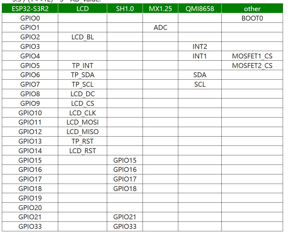

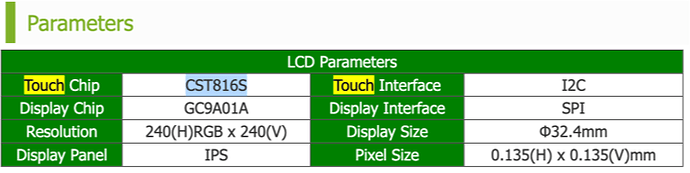

When I run the Test_Touch_Controller.ino, it fails. I've tried several different pins for the touch and none of them have worked.
What I don't understand is the documentation says the touch screen shares an I2C connection, which is two lines, but these sketches seem to imply that the touch screen will come over only one GPIO pin. Comments?

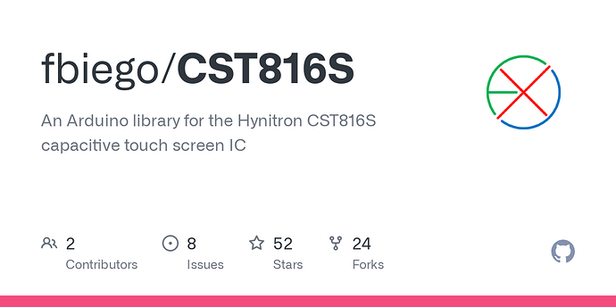

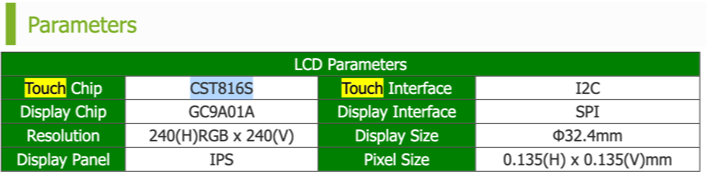

The touch driver of your display is "CST8165S".
So I think you can use this library.
You can download it from Library Manager.
https://docs.arduino.cc/libraries/cst816s/
Thank you for that. I tried the touch_test.ino with a whole bunch of different values based on the documentation for the following command, but none of them worked.
CST816S touch(6, 7, 13, 5); // sda, scl, rst, irq
Pin assignment looks good.
Then please check the I2C address. The library assumes it is 0x15 in CST816S.h.
#define CST816S_ADDRESS     0x15
You can get the I2C address of your device using i2c_scanner:
https://playground.arduino.cc/Main/I2cScanner/
I ran the scan, but all I got was gibberish even though I matched the 9600 baud rate. The instructions DO say this, though.
This sketch tests the standard 7-bit addresses
// Devices with higher bit address might not be seen properly.

Here is the datasheet from waveshare.com:
https://www.waveshare.com/w/upload/5/51/CST816S_Datasheet_EN.pdf
It says:
So 0x15 might be OK.
This message typically appears when I2C communication fails.
Maybe try asking the seller for support?

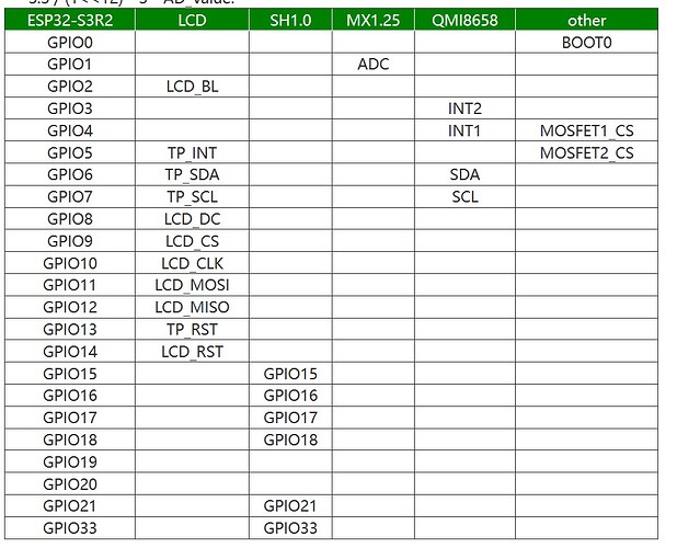

By the way, you can refer your pin assignments in here:
This header file will be loaded automatically by Arduino IDE. So you can:
CST816S touch(SDA, SCL, TP_RST, TP_INT); // sda, scl, rst, irq
I used a second scanner from Nick Gammon and it didn't see anything either. I do know the touchscreen works because the sketch it came pre-loaded with worked.
The document shows the I2C on GPIO 6 and 7. Is the hex address just either 6 or 7 in hex?
Yes. Using SDA, SCL is better.

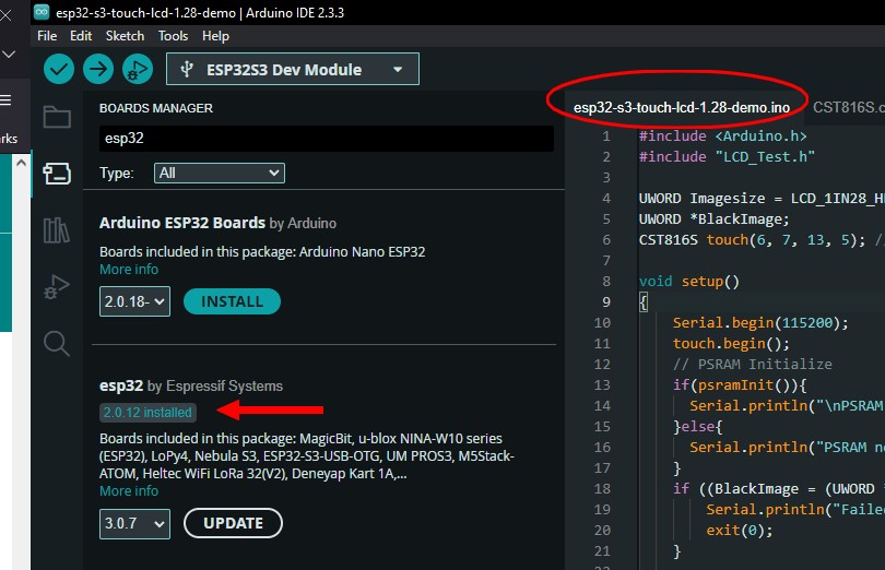

It look like it's having trouble finding uint8_t TwoWire in the Wire.h library. But I don't see that .h file called out in the program. But I also don't see it in my library. Sooo. . . I'll go get it and see what happens.
Man, I swear, everything is like pulling teeth. The CST816S.cpp file DOES call Wire.h, so I go to the libraries and it doesn't come up. I do a search online and an answer in a forum tells me where to find it, except that location doesn't seem to exist on my computer and/or I can't seem to find that location. I performed a search on my computer and nothing. I went to github and found it there. I created a new tab, called it Wire.h and pasted it in. Now it errors on TwoWire, but in Wire.h it seems to call out a TwoWire_h not a TwoWire.h. What do I do with that?
Did you read "Install Arduino-ESP32" section in WaveShare's wiki ?
I think your version of esp32 board package might be 3.0.7, the latest. So try to downgrade it to 2.0.12.
This may be the reason why i2c_scanner failed and why you experienced such compile errors.
Edit: You can downgrade it from "Board Manager".
Yeah, I read it. It's 2.0.12. The board literally won't work with newer versions.
Oh, I'm sorry. There's "2.0.12" in error message you posted.
