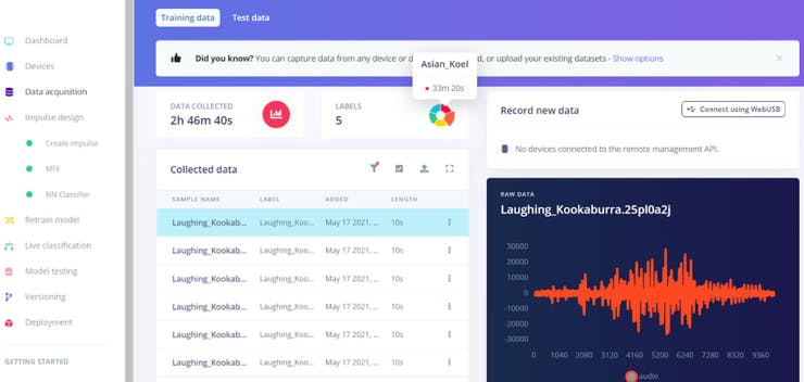

Building a Dataset
We downloaded around 20-25 audio files for each bird and worked on preprocessing using software called Audacity. And then proceeded to augment the data, while infusing noise. And this helped us generate 200 files of 10 seconds each for all four of the above-mentioned labels as well as a label for thenoise alone.
We now have a balanced dataset with 33 minutes and 20 seconds of data for each label in training and 8 minutes and 20 seconds of test data.

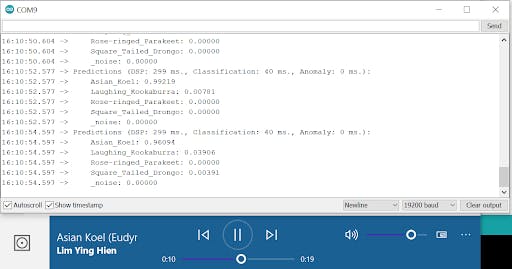

To ensure that the model works as well on new and previously unseen data as it has for the training data, we can use the option of ‘Live classification’ provided by the studio.
Click on Live classification in the left-hand menu. Your device should show up in the 'Classify new data' panel. Capture 5 seconds of background noise by clicking Start sampling.
We performed live classification of data using both our smartphones as well as the Arduino Nano 33 BLE Sense.
