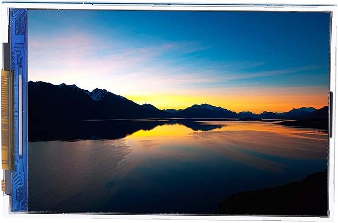

Hi All,
I am messing around with TFT displays now and have been interested in my TFT displays bitmap function, however, it is very slow. when doing any other kind of colour printing/messages it is about as instantaneous as I'd expect, but when doing bitmaps it takes almost 30seconds to fully update the 320x480px screen.
I'm wondering if this is normal for this type of display and setup and if not then, how can I speed it up! Ideally I'd like to display simple animations!
Screen: 320x480 3.5" TFT LCD Display, ILI9486 driver. 8-bit display.
Ardunio: Mega2560
Using SPI communications
Bitmap files are on a FAT32, 8GB SDcard
My working theory is because its only operating at 8 bit? I have ordered a 16bit just to continue playing. Code Below!
Thanks!
Diesel

Post a link to the actual display that you have bought. e.g. Ebay sale page.
Quote a genuine Arduino board by name.
Or post a link if it is a non-standard Arduino.
David.
It is a regular "Mcufriend Uno Shield".
You don't say whether you are using Uno, Mega2560, Due, ...
It will always be fairly slow on a Mega2560.
And if you choose to use the badly spelled library you can guarantee that most Arduino projects will be incompatible.
David.
the TFT display did say it was compatible with the UTFT library, I couldn't get it to do anything with that library sadly.
Sounds like I just need to find a more reliable brand of TFT display! :smiley:
Shops LIE.
You still have not said which Arduino board you want to use.
I thought I said above, I am using a Mega2560
My apologies. The screen is 8-bit parallel. The screen does not use SPI. But the SDcard does use SPI.
Yes, a 16-bit parallel Mega2560 display Shield will use PORTA, PORTC digital #22-37. This will work at a reasonable speed if you use a sensible library like Bodmer's TFT_HX8357.h library.
But your existing shield will work pretty well with an Arduino Due clone.
Most importantly, you can display JPEG images from PROGMEM.
David.
Yeah, gonna wait till I get an 16 bit display.
I thought that is what I ordered, but I just figured it wouldn't matter too much, the files I managed to get with it are...ironically for the 16bit variant, so going by their instructions, getting it to work as wired wasn't gonna do the trick! its working though, I spent most of this morning attempting to use another library, but I just can't seem to get another library to generate anything on the display, even simple things! I'll have a look into the HX8357!
Thanks for your help!
Diesel
MCUFRIEND_kbv can be installed via the IDE Library Manager.
All the library examples should work straight out of the box.
David.
