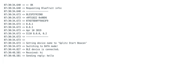

I would like to be able to communicate back and forth between the a BlueFruit Arduino Feather and an Espruino Puck.js.
Here is my bare bones Arduino Code that I am trying to get to work. It should be a simple - send value from the Puck.js to the Feather (which I am able to do), and then for the Arduino - depending on the value received, send back a specific value to the Puck. All using BLE.
The issue I am having is that the Puck is throwing a CCCD Handle Error.
I'll try to add as much code (with their outputs) and images as possible. Any assistance would be amazing!

Puck output response:
Trying to connect to Arduino Board.
Connecting to device...
Connected to GATT server
Got UART service
BluetoothRemoteGATTService: {
  "device": BluetoothDevice: {
    "id": "ff:8d:05:ae:17:64 random",
    "rssi": -61,
    "data": new Uint8Array([2, 1, 6, 2, 10, 0, 17, 6, 158, 202, 220, 36, 14, 229, 169, 224, 147, 243, 163, 181, 1, 0, 64, 110]).buffer,
    "services": [
      "6e400001-b5a3-f393-e0a9-e50e24dcca9e"
    "gatt": BluetoothRemoteGATTServer: {
      "device":  ... ,
      "connected": true, "handle": 1 }
  "uuid": "6e400001-b5a3-f393-e0a9-e50e24dcca9e",
  "isPrimary": true, "start_handle": 31, "end_handle": 65535 }
Got RX characteristic, sending 'hi'...
BluetoothRemoteGATTCharacteristic: {
  "service": BluetoothRemoteGATTService: {
      "rssi": -61,
      "services": [
"device":  ... ,
    "isPrimary": true, "start_handle": 31, "end_handle": 65535 },
  "uuid": "6e400002-b5a3-f393-e0a9-e50e24dcca9e",
  "handle_value": 37, "handle_decl": 36,
  "properties": { "broadcast": false, "read": false, "writeWithoutResponse": true, "write": true,
    "notify": false, "indicate": false, "authenticatedSignedWrites": false }
Setting up TX Service...
      "rssi": -61,
      "services": [
"device":  ... ,
  "uuid": "6e400003-b5a3-f393-e0a9-e50e24dcca9e",
  "handle_value": 33, "handle_decl": 32,
  "properties": { "broadcast": false, "read": false, "writeWithoutResponse": false, "write": false,
    "notify": true, "indicate": false, "authenticatedSignedWrites": false }
Setting up listener for incoming data
Error: CCCD Handle not found
Arduino Serial Output:
