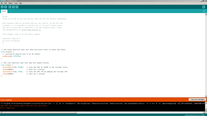

Many thanks for your reply Jomo. I have reinstalled 1.6.7 (stable version) and unfortunately the same error exists (cannot find the file specified). I have attached the updated error message in notepad plus a screenshot
I have looked again in the "Preprocs" folder and again it is empty.
I am considering updating to Windows 10 and trying again. Note that I have installed Arduino 1.6.7 IDE on a friends Windows 7 laptop and Blink compiles / uploads perfectly with my board - so it looks like a windows 7 issue?
Also I have donwloaded latest JAVA update but this also did not seem to help.
any thoughts / suggestions are appreciated
Blinkerror 1.6.7.txt (2.88 KB)

This is an IDE bug but it is easily worked around. Simply save your sketch, close the IDE and re-open it. It works every time.
