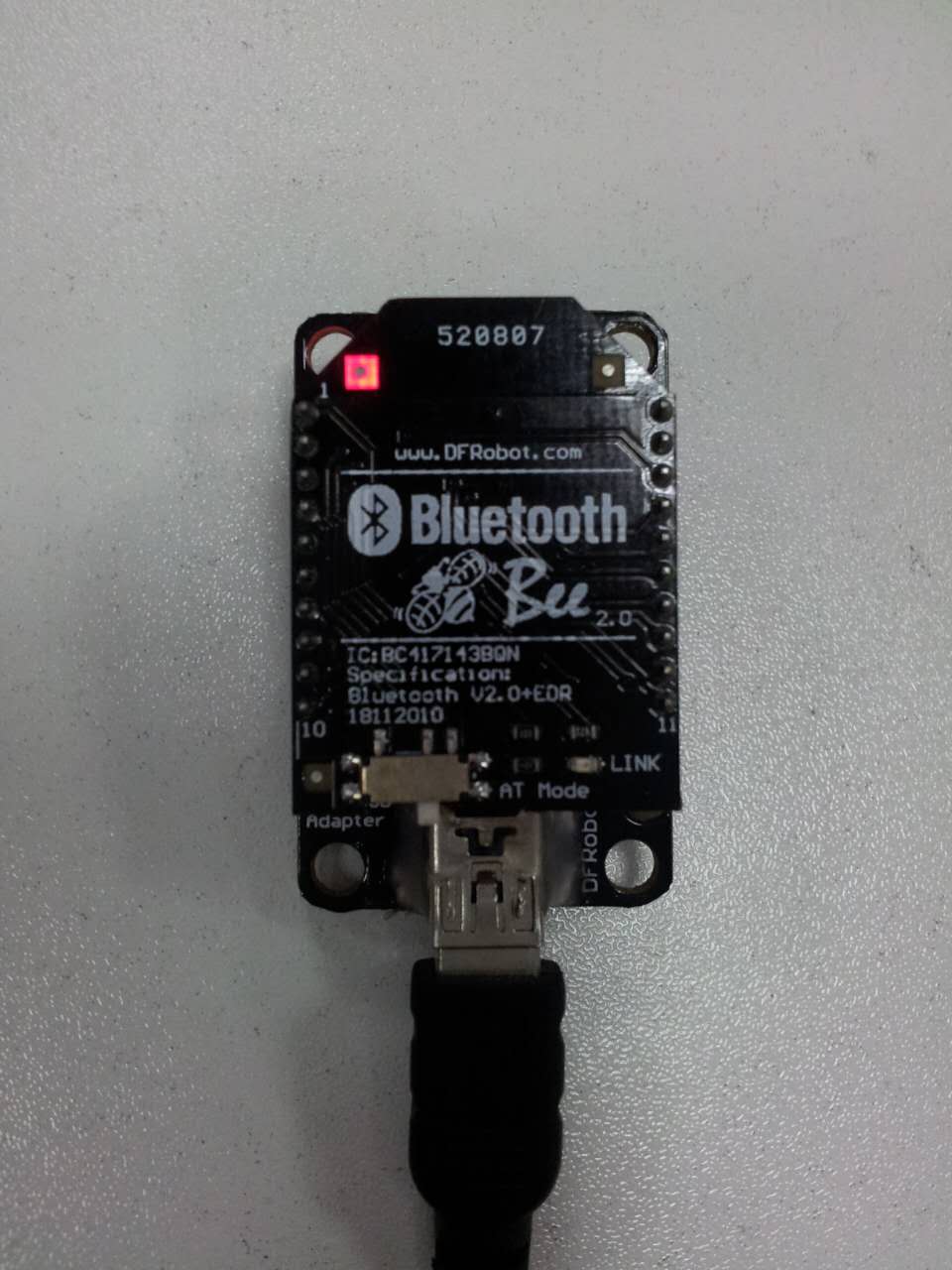

Hello,
I'm trying to connect two Arduino with Bluetooth, but I have trouble connecting my bluetooth Bee 2.0 to my HC-06 module... I searched on Google and tried many different things, but it seems like I'm missing something important. Could someone give me an advice, please ?

There it is : DataSheet
and the link of the product itself if you need it : DFRobot Bee 2.0
Have you followed the DFRobot tutorial?

I did, but I don't understand : when the master got the slave adress, is it supposed to automatically connect to it ? If not, how can I do this ?

In fact there is no sample code on the DFRobot page, only some commands to set up the module, like the one which allows to bind a master to a slave module (the master being my Bee 2.0 and the slave my HC-06) : AT+BIND=1234,56,abcdef (which corresponds to the slave adress). I did bind the two of them, but it seems like it needs something else to connect.

Thanks, this tutorial is way better than the other ones ! My two modules are now paired and everything but my Arduinos still can't communicate... I checked the Baud rate and it's 9600 on both, I also checked the program but I can't find the new problem x).
You might try Martyn's code as well. Yours doesn't look too kosher - particularly the timing.
I used his code :smiley:
In AT mode the bluetooth modules were communicating but when I connect them to an Arduino nothing happens. Maybe this is an hardware issue ?

Well, I can see both of the modules with my phone and I'm almost sure that they are comunicating by bluetooth, and the reason I doubt for the hardware is that the Bee 2.0 (which I use like an HC-05) needs a direct connection to the computer with a special wire to be configured in AT mode; we cannot configure it by wiring it to the Arduino... That's why I think the issue is from the wires, because I cannot find any other solution.
Being "almost sure that they are comunicating" is the same as being a little bit pregnant. And your post is still incoherent. One thing you need to be clear about whether you have actually configured HC-05 or not - by whatever means. If not, I guess you should not be "almost sure that they are comunicating" at all. I don't know anything about Bee2.0, but it has a switch for selecting AT mode, so I don't see why you need a special wire. Further, if you are configuring with PC, I fail to see how the wiring can be at fault. You can hardly connect it the wrong way round, although you might test the cable on something else. DFRobot has stuff on these, and I imagine that is all you need. At a guess, the same switch would be used with Arduino, and you only need four wires to connect.
I did everything said in the tutorial : baud rate to 9600, same passwords, pairing, linking and binding the Bee 2.0 to the HC-06, and they do connect because their LEDs stops blinking 5s after powering them on. In fact, the only thing (to me) that could be the answer is the baud rate, but I checked it again and again... I know the wires are not the problem because I tested them, but at my level I just can't see what's wrong.
Wtf ?? When I pin DRX(Bee 2.0) to RX(Arduino) and DTX(Bee 2.0) to TX(Arduino) the code works ! I don't understand but I'll take this :stuck_out_tongue_closed_eyes:
Nor do I, but the only thing I know about Bee is its eyewatering price. I can only assume that Bee Rx should be connected to Arduino Rx because it is also connected to Bluetooth Tx. Anyway, it looks like you have solved the problem.
