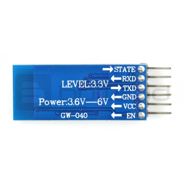

What sort of breakout board is the HC-05 on, if any?
Colleague of OP here
We haven't included the HC-05 in the code yet (it works, though). The problem is that just wiring the HC to the Arduino in any way (without coding) interferes with the MPR data we get via USB.
As for the HC-05, we are using one that looks like this: https://botland.com.pl/19754-thickbox_default/modul-bluetooth-hc-05-gw-040.jpg

OK. I know nothing about the MPR121 but it would appear to have nothing whatsoever to do with Bluetooth, and that would apply irrespective of you using software serial or proper hardware serial.
I'm afraid I can only guess that the wiring is not as kosher as you think. The most obvious place to check is the grounds.
