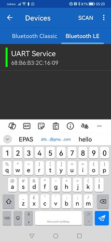

select Tools\>Board then ESP32S3 Dev Module
the open File\>Examples\>BLE\>UART
compile, link, upload and run - serial monitor should display
```arduino
Waiting a client connection to notify...
on an Android phone run [Serial Bluetooth Terminal](https://play.google.com/store/apps/details?id=de.kai_morich.serial_bluetooth_terminal&hl=en-US)
under Devices select "Bluetootrh LE"
you should see device "UART Service"
you should be able to transmit/receive serial text

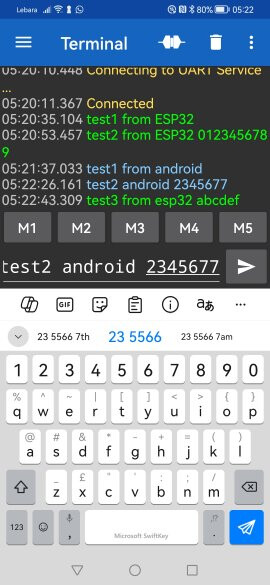

Well, some improvement, BLE\_uart.ino does work, mostly.
I can send text such as “Hello World” from the Android device to the ESP32S3 and it displays in serial terminal.
But the Android phone terminal screen is full of continuous characters, looks like from 0 to 0xFF, as in the picture you posted. .

I have found that Adafruit Bluefruit Connect will work as an ascii terminal program between an esp 32 and an android phone.
[https://play.google.com/store/apps/details?id=com.adafruit.bluefruit.le.connect&hl=en\_US](https://play.google.com/store/apps/details?id=com.adafruit.bluefruit.le.connect&hl=en_US)
I run this program on the esp 32.

ESP32 serial monitor
```arduino
BLE transmit: test1 from ESP32
BLE transmit: test2 from ESP32 0123456789
BLE Received: test1 from android
BLE Received: test2 android 2345677
BLE transmit: test3 from esp32 abcdef
Android phone terminal output
 ![image](https://europe1.discourse-cdn.com/arduino/original/4X/2/6/0/260bde9084525bf745f539e9fd47a87470b8792c.jpeg)

> [@cattledog](#):
> I can find no differences between the what you have posted and the code in Post #6.
looks very similar - looking at the date on the .ino file of post 8 it appears to have been implemented (using UART example as a start) about 5 years ago
> [@cattledog](#):
> I can not get either of them to connect to the Morich Serial Bluetooth Terminal app in BLE.
it defaults to Bluetooth Classic - under devices did you select Bluetooth LE and UART Service
 ![image](https://europe1.discourse-cdn.com/arduino/original/4X/3/e/5/3e5c644c384c4a0dc65b45c990fc723bc5ff4b60.png)
using a Huawei P30 Pro
