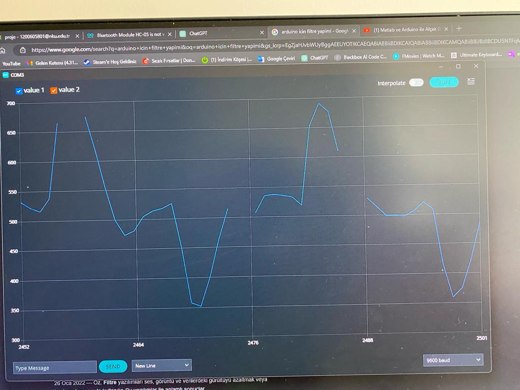

We connected both the HC-05 Bluetooth module and the Pulse Heart Sensor module to Ardiuno. I connected the analog information cable on the pulse module to the A0 input of the Arduino, and the cables on the RX and TX legs of the Bluetooth module to the RX and TX inputs of the Arduino. After writing the code and running the Arduino, I see the two analog inputs mixed together on the Serial plotter screen. Can you help?

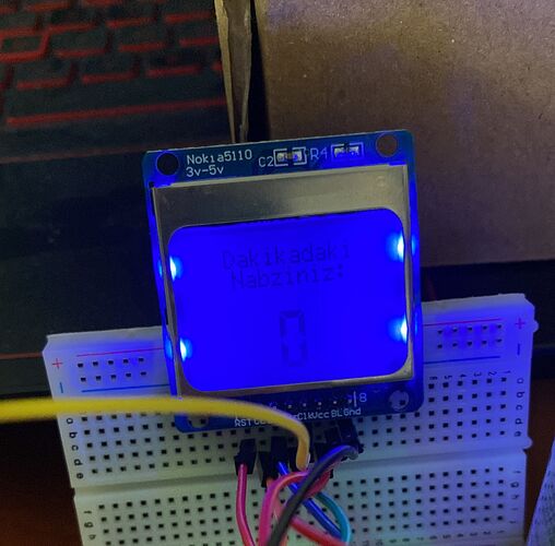

What do you see on LCD5110?
What two analog inputs?
1-) We get text on the screen like the image I gave below, and we see everything coming from the pulse sensor on the screen in the void loop().
2-) I thought there was an analog signal coming from both the heart rate sensor and the Bluetooth module, but my mistake is that the analog signal is coming only from the heart rate sensor, but why do we see 2 signals on the serial plotter screen in the photo I gave above (like value 1 and value 2)?
I'm not a user of the Serial Plotter so I don't know the reason for your observations. My guess is that it has to do with the multiple Serial print statements in the code. Try with just the variable of interest being printed
