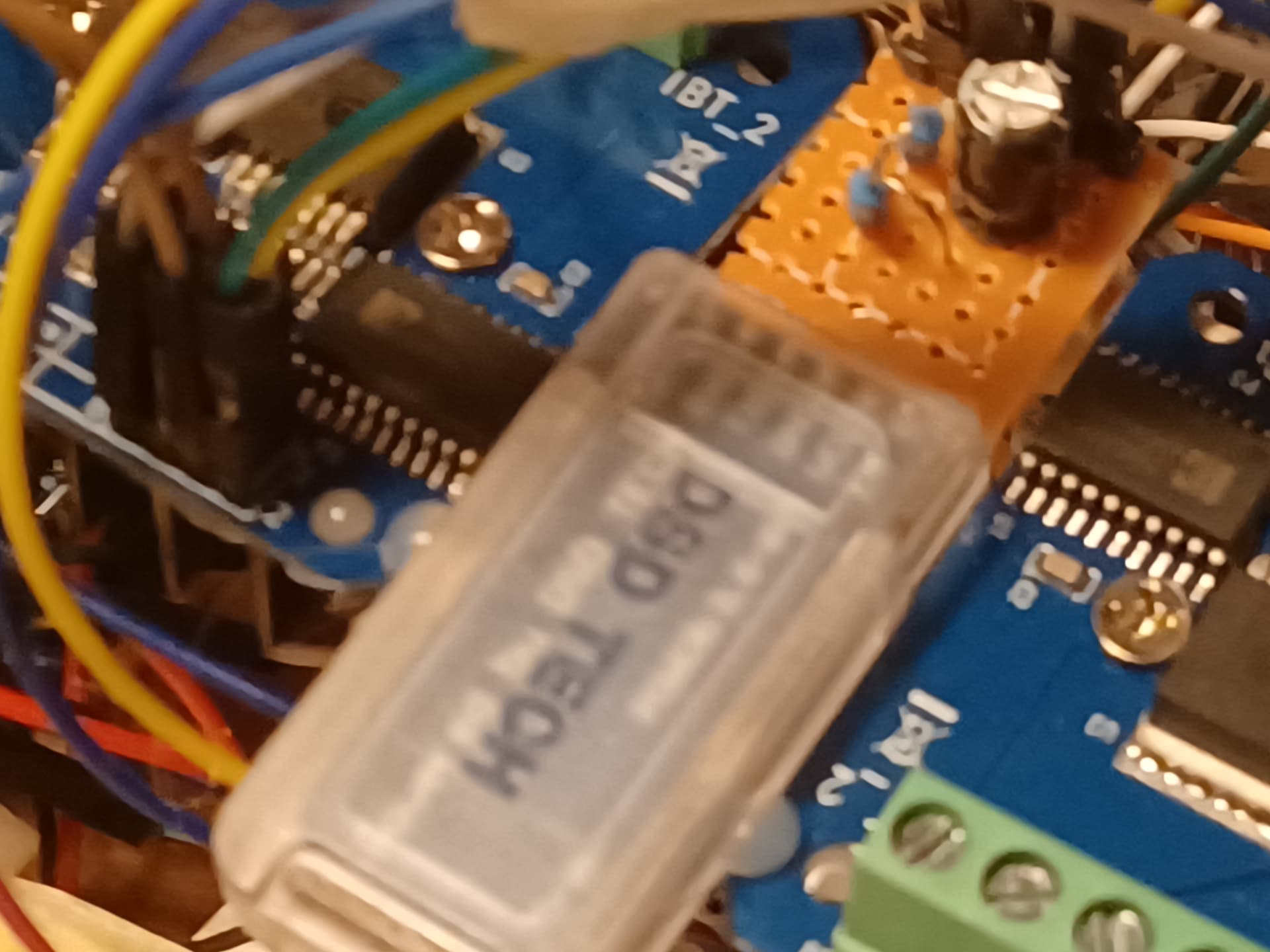

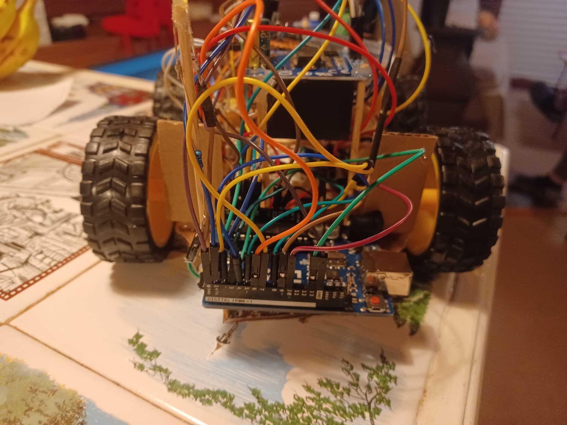

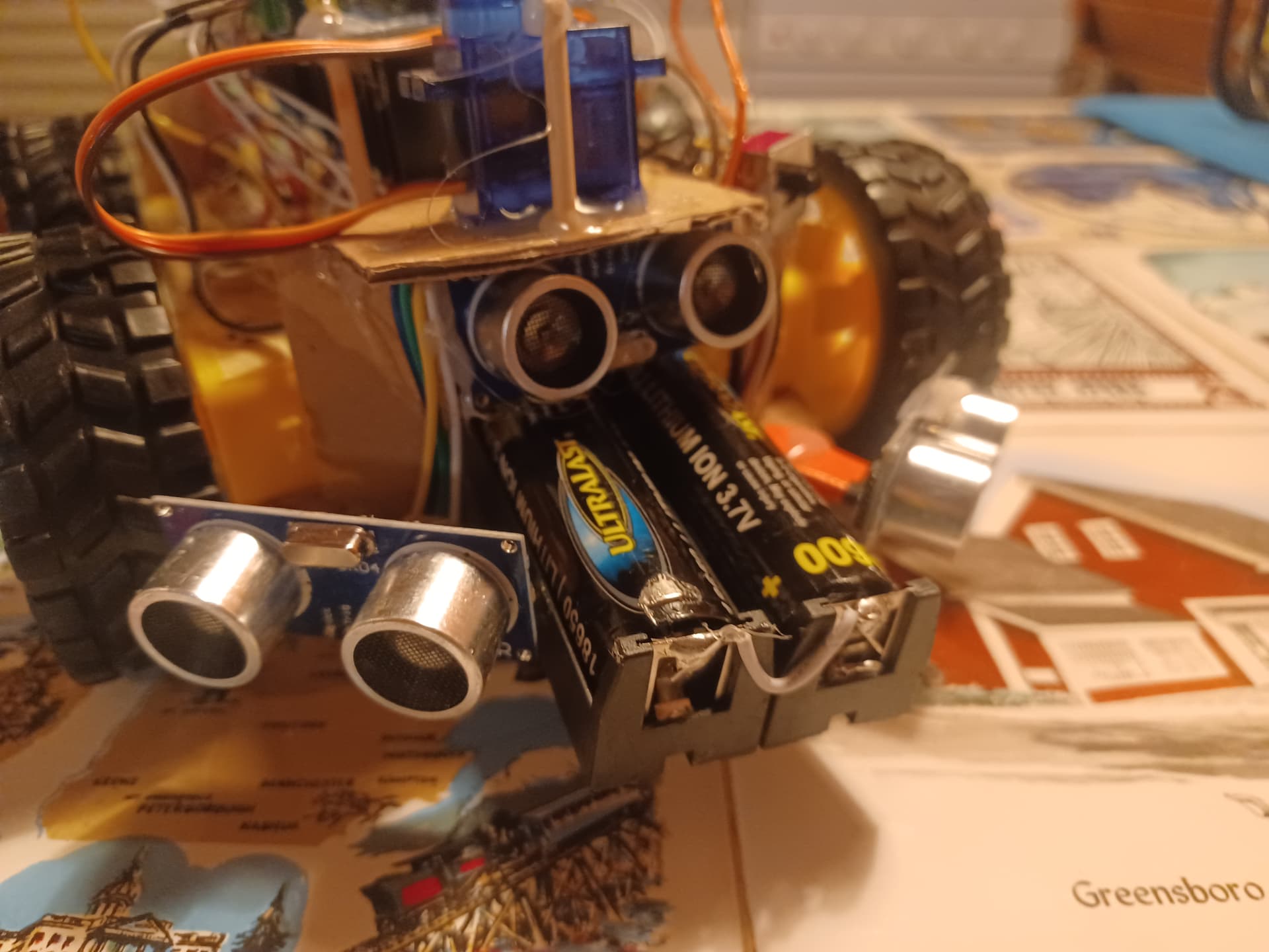

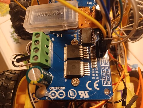

Hi all,
I have been struggling with this project for a couple of weeks now, and one after another problems keep showing up. I have this car that I have built from scratch, and it can be controlled by a Bluetooth app made in MIT App Inventor. The 4 TT geared motors are controlled by 2 BTS7960 motor drivers. The problem is that when I try and control the car from the app, the motors only work when I give them full power from the Android app over BT. It has worked before, but now that I added some more features (a controllable servo) it has seemed to only work at full speed. Here are some images for an idea of what's going on:
I can provide more images if necessary.

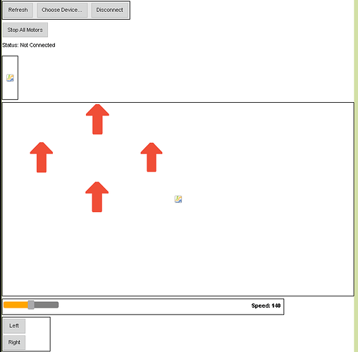

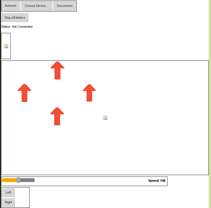

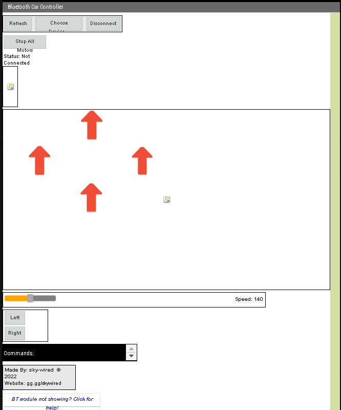

I'm not sure if you will need this, but I will provide an image of the code I am using in MIT App Inventor:
I know this is a strange and possibly pretty confusing question, but if you need any more detail or wiring diagrams, just let me know!

Sounds like a wire has come loose. Check all connections for validity and continuity.
Write simple test programs that individually exercise and test each functionality (motor control, sensors, etc.).

I have now checked all the wires and did many experiments on the motor drivers. I can only get one driver to spin the motors properly, while the other one does nothing. I have traced the problem down to the 2 PWM pins used for controlling the non operational driver. I then uploaded a simple fade sketch, and connected an LED to the "broken" PWM pins, and they work just fine. I uploaded the motor code again, and tried swapping the wires to the motor drivers and now the second driver works just fine, but the first one doesn't work at all. If I'm correct, I think it may have something to do with my code. I have been staring at this for way too long, and I'm really hoping another pair of eyes may catch my simple mistake. Here are a few snippets:

Finally. After I have completely removed everything and kept only the code for the motors, I finally got it working!!! :smile: The problem was actually the servo. Not sure why, but calling servo.attach() made the motor drivers do very strange things... Removing the servo code made everything work perfectly! I will try and write some code that doesn't require the servo.h library, so that I can hopefully keep the servo. Not sure if that will help with the servo, but I got what I wanted!

Sorry, I didn't notice you were using a servo.
The standard servo library conflicts with the analogWrite PWM, knocking out Timer1. Use the ServoTimer2 library to get around that.
Don't try to power the servo from the Arduino 5V pin, that can damage the Arduino. Use a separate power supply for the servo, and connect the grounds.
Wow, it all comes together now! have an external 5V regulator powering the servo separately, so current isn't a problem. I had no clue that the servo library messed with the PWM system. That's great to know! I have learned a ton just from this thread. I wish I could mark multiple comments as answers :wink: Thank you very much!
