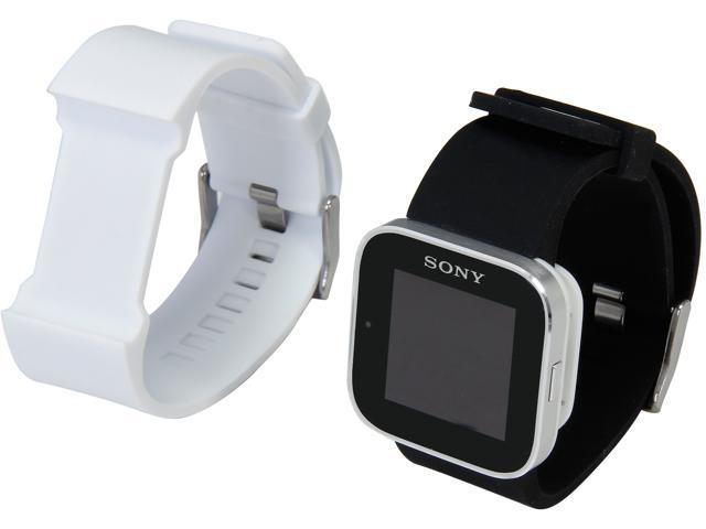

Essentially I want something like this:
But for quite a bit cheaper and way more fun! I would end up putting this on my bicycle or motorcycle for when I go on long rides, its hard to change songs and I would like to know the information.

What will you have running on the Android device? That's the more difficult side. Sony provides software for the phone that interfaces with the watch. The Arduino side will just send/receive serial data over bluetooth. The watch probably also supports the media player control (AVRCP) and phone control (HFP/HSP/PBA(P)/HID) profiles, that many bluetooth modules used with the Arduino don't support.
dxw00d,
Thanks for the informative reply, I'm not a good programmer to begin with and I have no idea how to program anything for Andriod. I think this project will be pushed aside......for now. Unless anyone wants to help me making a library / app or something of the such.
