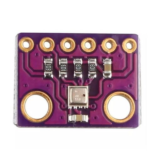

I have this sensor
How can I connect with arduino spi interface?
In the description I read that I can use either I2C or SPI.
Can You help me ?
I have this sensor
Can You help me ?
That 4-pin module only has the I2C pins exposed. You need one of the versions with 6-pins in order to use the SPI interface.
Don
If you can solder, you might be able to solder wires from the sensor chip to some pins. This datasheet has the pin desiginators https://ae-bst.resource.bosch.com/media/_tech/media/datasheets/BST-BMP280-DS001.pdf.
Idahowalker:
There's more to it than just connecting more wires which is why I deliberately did not mention this solution in my original answer.
In order to change modes it is necessary to change the connection to the CSB pin which may or may not be a simple task depending on the pc board design.
I seriously doubt that someone with the background and equipment needed to effect this type of modification would be asking this question in the first place.
Don
floresta:
I seriously doubt that someone with the background and equipment needed to effect this type of modification would be asking this question in the first place.Don
I, also, have the same doubt.
